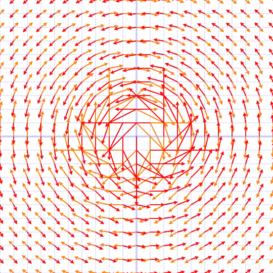

First, let's consider the magnetic field around an infinite, straight conductor with uniform current throughout. In this image, the conductor is just right of center, and the current is coming straight out of the page.
field from one conductor with uniform current

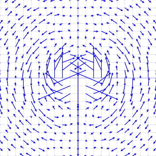

Now let's add next to it another conductor, with the current going the other way:
fields from two conductors with opposite uniform current

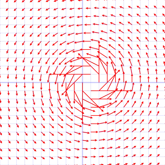

Add these fields together, and you get:
For distances far away relative to the conductor spacing, the fields are equal but opposite, so when added together they cancel. Radiation is, by definition, a field that extends to infinity. If there are no fields far away, then it can't be radiating.

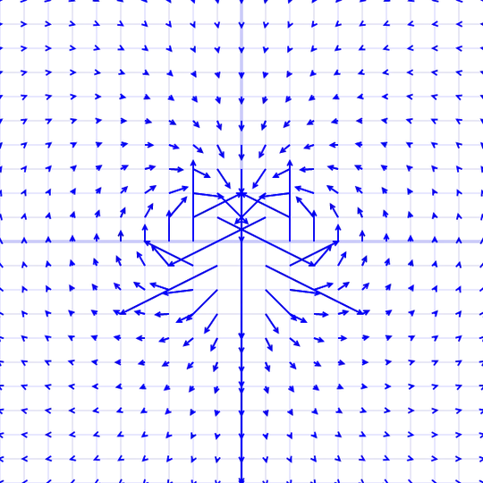

However, when the conductor spacing is large, then this is no longer true. Remember, the current is reversing direction periodically, and if we look at the field from just one conductor this means the field is alternating between clockwise and counterclockwise swirl. The changes to this field only propagate at the speed of light, so if we zoom the graph out to be a wavelength wide or more, we'd see those changes propagating away as waves.

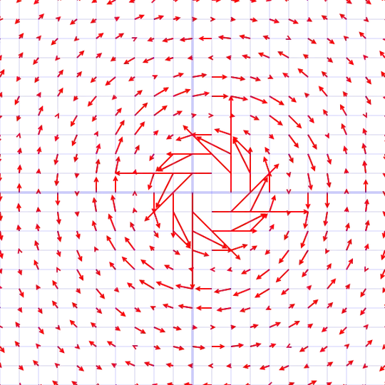

In the image above, the wavelength appears to be approximately four units. Now if we add that second conductor, two units away, we get this:
Notice how the fields don't cancel. They don't cancel because on the scale of the conductor spacing (which is not small relative to the wavelength) there can be significant changes in phase. Thus, there are regions of constructive interference where the fields don't cancel. These regions extend out to infinity, and thus, the feedline radiates.
