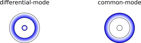

Skin effect does not make the inside and the outside of the shield function as distinct conductors. Think about the contradictions this would make: how does current "know" if it should flow on the inside or the outside? How would open transmission line stubs work if the shield current on the inside "wrapped around" and traveled back on the outside upon reaching the end of the coax? How could twin-lead choke baluns work?
There's a phenomenon similar to skin effect called proximity effect. It's relevant to transformers and twin-lead, or any application where two or more conductors in proximity are carrying RF current.
When two conductors are carrying currents in opposite directions (differential-mode), the current density is highest in the regions closest to the other conductor. When the current is in the same direction (common-mode), current density is highest in the regions farthest apart.
Both skin and proximity effects arise due to eddy currents. Skin effect is a special case when there's just one conductor, with the current density trying to get as far away as possible from all the other parts of the conductor trying to carry current in the same direction.
So in the case of coax, for a common-mode current the current density will be highest on the outside of the shield since that's the farthest point away from all the other points in the coax.
For a differential-mode current the current density is highest on the inner surface of the shield and the outer surface of the center since that's the closest points between the two.
This isn't skin effect creating a magic barrier between the inside and outside of the shield. It's eddy currents reinforcing some currents while cancelling others. It's the same underlying physics as skin effect, but there's no magic barrier. The inside and outside of the shield are not "distinct conductors".
