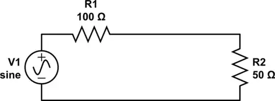

A 50 ohm feedline terminated in a 50 ohm load (the receiver) is indistinguishable from a 50 ohm load without a feedline. So really, what you are asking is what happens when a 100 ohm source is connected to a 50 ohm load. The feedline is irrelevant.
schematic
simulate this circuit – Schematic created using CircuitLab
Is this necessarily bad? True, if you can't change R1, then R2 should also be 100 ohms if you want to maximize the power in R2. But if R2 is zero ohms, current is maximized. And if R2 is open, voltage is maximized. What do you want to maximize, power, current, or voltage?
For a receiver, the answer is probably none of these. Instead, you want to maximize the signal to noise ratio. Extracting the maximum power from the antenna might be important, especially as noise power from sources internal to the receiver, such as thermal noise, become significant relative to what's available from the feedpoint. But this is only one of many considerations. For example, the receiver likely has some passive filter which was designed with a particular source impedance assumed. When the source impedance deviates from the design value, the filter performance may degrade.
So, your question is actually quite difficult to answer. Receivers aren't simply resistive loads: they also have filters and active, nonlinear electronics, and the power extracted from the antenna is only indirectly relevant to receiver performance. Ultimately the answer depends on the receiver details.
