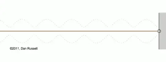

In practice, only some of the power is reflected back, and the result is a partial standing wave. Dan A Russel has a page of great animations, like this one:
In the case of a partial standing wave, we can see that the envelope (outlined by the dotted lines) does not reach 0 amplitude at the nodes. In this case, some power is transferred. This is also a good visualization of VSWR: it is the ratio of the voltage amplitude at the antinodes (envelope maximums) to the voltage amplitude at the nodes (envelope minimums).
Notice also that the reflected wave might arrive back at the transmitter in any phase, depending on the length of the feedline and the antenna's reflection coefficient. It may or may not be in phase, but it will be a constant phase, not just noise. By adding an antenna tuner we can reflect the reflected wave back at the antenna, and adjust the phase of this re-reflected wave to be whatever we want, within the limits of the tuner's capabilities of course.
