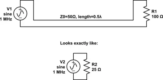

It's true that if the transmitter is sending a pure sine wave which began infinitely long ago, and will continue on forever, then we can take the mismatched load impedance, rotate it the appropriate amount according to the length of the transmission line, and arrive at some impedance that the transmitter sees. And, from the transmitter's perspective, this long transmission line plus the mismatched load is indistinguishable from a lumped impedance right at its output.
For example, this is exactly true:
schematic
simulate this circuit – Schematic created using CircuitLab
This is a simplification we can make in some circumstances. The problem with your statement is you neglect the conditions:

Of course, such a signal contains zero information, and real communications are never like that. Real transmissions modulate a carrier over time. Or we can say the same thing in the frequency domain: real transmissions aren't just one frequency.
As such, we can't reduce the entire system to just one impedance that the transmitter sees. For a complete analysis we must think about the frequency response of the system over the entire range of frequencies present in the signal. We can depict the frequency as a Bode plot which shows the changes in magnitude and phase present in a system.
