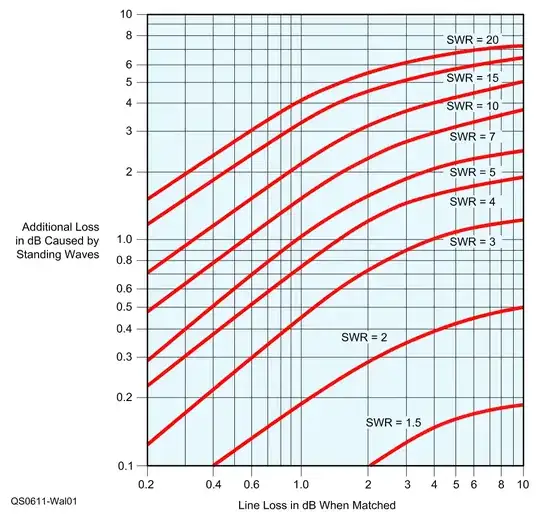

There has been a long discussion of one question here. Phil, W8II and I agreed that it's better to post a separate question.
There are several sources (some editions of "The ARRL Handbook", "Reflections: Transmission Lines and Antennas", Understanding SWR by Example) where you can find plots like this one:
Let's say the antenna impedance on a given frequency is 250 Ohm, the feedline is 50 Ohm. Between the antenna feed point and the feedline SWR = 5, ~44% reflected power. The model says that 44% of the transmitted power will be reflected from the antenna to the feedline, re-reflected by the transceiver, and go back to the antenna. If the feedline is lossless, eventually 100% of power will be radiated, regardless of SWR. If the feedline has losses, there will be additional losses as the plot shows.
The problem is that none of the sources explains well why the transceiver suppose to re-reflect all the power. Actually, in "Reflections" on p13-5 it's said that the model is not valid for modern solid-state PA. This is what the long discussion was about.
Phil suggested that what actually was meant is that a tuner between the transceiver and the feedline re-reflects the power (a tuner is lossless for this model), not the transceiver per se. If this is true, I don't quite understand the situation either. On one hand, it is stated that since the PA sees 1:1 SWR there is no reflected power going through the tuner. This makes sense. But for received signals, we say that the same tuner matches whatever impedance it sees to 50 Ohm and passes all the signals through to the transceiver. I don't see how it's possible for the same device to pass signals in one case and reflect in another when signals go in the same direction, to the transceiver.
So actually I have several questions: 1) is the described model accurate for modern transceivers? 2) if yes, is a tuner required? if no, why? 3) does the tuner actually passes the received signals and reflects the transmitted signals?
  • As you say, if the tuner does all the tuning work, fully transforming the antenna+line impedance so that the transceiver sees 50 ohms, then the transceiver's own output impedance is irrelevant. – tomnexus Apr 14 '21 at 15:06
    Re the paragraph after the figure: "The model says that all the transmitted power will be reflected from the antenna to the feedline, re-reflected by the transceiver, and go back to the antenna." Surely you mean re-reflected by the ATU? The transceiver may reflect, may not. But the tuner, if tuned, will reflect it all back. – tomnexus Apr 14 '21 at 15:52
  • @tomnexus this is basically my question. I completely agree that the transceiver may reflect the power or may not. If that's true the ATU reflects all the power that goes to the transceiver then why it doesn't reflect the received signals as well? I updated the question a little to make an accent on this part. – Aleksander Alekseev - R2AUK Apr 14 '21 at 20:49

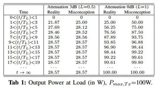

The following experiment illustrates the difference in bouncing-steps. We assume a system that is easy to calculate (and easy to measure!). A lossy 50Ω coax is terminated into an ohmic resistor of 290Ω. This load resistor implies that half of the forward power is reflected at the load, $$|Γ|^2=|(290-50)/(290+50)|^{2}=0.5$$ The coax line attenuation is 3dB (i.e., L=0.5). The coax length is a multiple of (λ/2); such length-choice avoids here the hassle of complex values and implies that the feedline input impedance is also ohmic; it is 104.9Ω (obtained by calculation, or Smith Chart etc.). We assume a (lossless) LC tuner that matches the feedline input impedance of 104.9Ω to the transceiver output impedance (say, 50Ω). Thus, the tuner output impedance (seen when looking from the feedline into the tuner) is adjusted to be also 104.9Ω. The signal components that return to the feedline input, experience reflection with a coefficient $$Γ_s=(104.9–50)/(104.9+50)=0.35$$ or $$|Γ_s|^2=0.13$$ (instead of any faked $|Γ_s|^2=1$).
Inserting the values into the “Total Feedline Loss” equation gives a system loss of 5.44dB (or linear 0.2857). If the maximum available power from the transceiver is 100W then – after the bouncing has finished – a steady power of 28.57W is delivered to the load resistor.
Connecting to the diagram in the Question, our system loss of 5.44dB includes the 3dB “Line Loss in dB When Matched” plus 2.44dB “Additional Loss in dB Caused by Standing Waves”; note our SWR is here (290/50) =5.8. The transceiver pumps 100W into the feedline. Part of this power (28.57W) is dissipated in the load at the end of the feedline; the remaining part (71.43W) is dissipated in the feedline which is quite lossy (here 3dB, means 50W matched line loss plus 21.43W additional loss due to SWR). There is no power going back into the transceiver because it is (via a (lossless) tuner) impedance-matched to the input impedance of the feedline. All power of 100W remains, and is dissipated, inside the system of feedline plus connected load. This applies regardless of the actual reflection coefficient (here $Γ_s=0.35$) being different from 1.
@sm5bsz (comment on separate Answer): “… regarding the diagram … It shows the fraction of the power sent into the cable that is converted to heat. (The rest is delivered to the antenna.)” (quote) That is a misleading statement. The curves in the diagram show only the loss due to SWR. The total loss (and thus the total power converted to heat) is higher by the added Matched Line Loss of the cable on its own.
For comparison, we also consider the case of a lossless line (L=1). The “Total Feedline Loss” becomes 0dB, regardless of mismatch at the load side. The input impedance of the feedline is now identical to the load resistor (remember the line being a (λ/2)-line), and the tuner is adjusted for an output impedance of also 290Ω. The reflection coefficient at TL input becomes $Γ_{in}=Γ=0.71$. The power delivered to the load resistor – after the bouncing has finished – equals now the maximum available power of 100W from the transceiver.
The following table shows the bouncing for the two cases of line attenuations and for the “Reality” of true partial re-reflection, and for the “Misconception” of total re-reflection. $T_L$ is the one-way delay time of the coax. The lower the line loss (in dB), the more evident become the transient discrepancies, and the bouncing will take longer until the steady state is reached.
Table

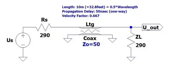

The “Reality” cases can be verified by measurements and by simple simulations; here is a simulation schematic (LTspice) for the discussed second case of 0dB feedline loss. The voltage $Us$ is scaled accordingly for a maximum source power of 100W.
LTspice Model

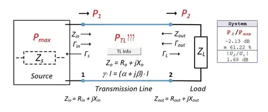

An Excel tool downloadable at www.rfclb.space/#TLine does all calculation and allows for “Total Feedline Loss” trade-offs considering different approaches of impedance matching by a tuner (far-end; near-end; complex conjugate matching; zero-reflection), or tuning by simple feedline extension; the tool covers also the case of complex characteristic impedance of the transmission line.
Transmission Line Power Calculator

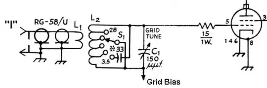

This is from a page by Greg Latta. Note the variable capacitor and switchable taps on the inductor: this is an L-network and could be used as an antenna tuner on its own. Tuning this network is part of the standard operating procedure for a tube PA, so in practice a tube PA always has an "antenna tuner".
Solid-state transmitters on the other hand don't necessarily have this feature. The output impedance of a transistor is lower and more stable, and thus it's feasible to design the circuit to drive a 50 ohm load without variable components.
