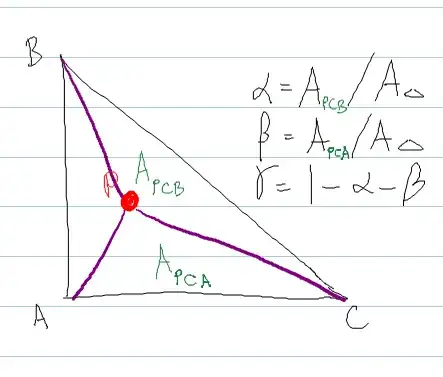

In my profiler, finding barycentric coordinates is apparently somewhat of a bottleneck. I am looking to make it more efficient.
It follows the method in shirley, where you compute the area of the triangles formed by embedding the point P inside the triangle.
bary
Code:
Vector Triangle::getBarycentricCoordinatesAt( const Vector & P ) const
  Vector bary ;
  // The area of a triangle is
  real areaABC = DOT( normal, CROSS( (b - a), (c - a) )  ) ;
  real areaPBC = DOT( normal, CROSS( (b - P), (c - P) )  ) ;
  real areaPCA = DOT( normal, CROSS( (c - P), (a - P) )  ) ;
  bary.x = areaPBC / areaABC ; // alpha
  bary.y = areaPCA / areaABC ; // beta
  bary.z = 1.0f - bary.x - bary.y ; // gamma
  return bary ;
This method works, but I'm looking for a more efficient one!

For a given point N inside triangle A B C, you can get the barycentric weight of point C by dividing the area of subtriangle A B N by the total area of triangle A B C.
