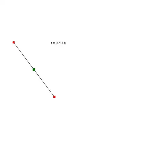

A simple linear interpolation should be enough here, since the sides are straight. For just one side, the equation is
$$p(t) = \vec a + (\vec b - \vec a)\cdot t$$
Where \$t\$ is a value between 0 and 1, \$\vec a \$ is one of the vertices of the side and \$\vec b\$ is the other. For \$t = 0\$ the returned position is \$\vec a\$, for \$t = 1\$ it's \$\vec b\$. Animation to make it clearer:
Now if you divide the \$[0,1]\$ interval into three equal parts, the first for the first side, second for the second part and the third for the third one, then you can create a function, that returns the positions of an equilateral triangle. If we have a triangle \$ABC\$ and the vectors pointing to the three vectors are \$\vec a\$, \$\vec b\$ and \$\vec c\$ respectively, then this function is
$$p(t) = \begin{cases} \vec a + (\vec b - \vec a) \cdot (t \cdot 3) &\quad\text{if } 0 < t < \frac{1}{3}\\ \vec b + (\vec c - \vec b) \cdot (t \cdot 3 - 1) &\quad\text{if } \frac{1}{3} < t < \frac{2}{3}\\ \vec c + (\vec a - \vec c) \cdot (t \cdot 3 - 2) &\quad\text{if } \frac{2}{3} < t < 1\\ \end{cases}$$
