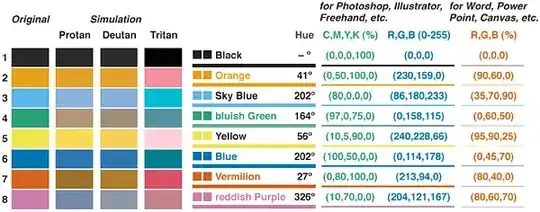

You can use this palette from the article Color Universal Design (CUD) - How to make figures and presentations that are friendly to Colorblind people - by Masataka Okabe and Kei Ito.
colorblind-save palette
Another option is to make the colors used by your game configurable in the options menu. That way everyone can figure out a set of colors which works for them.
