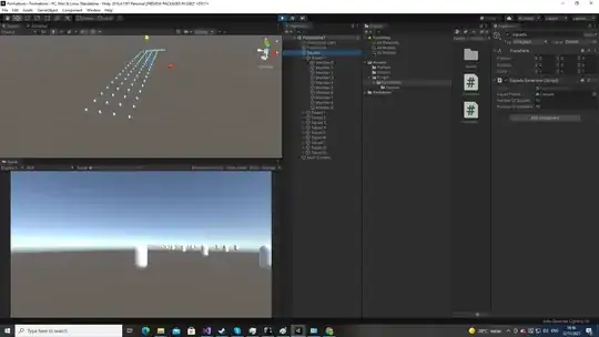

Screenshot of the hierarchy each Squad is empty gameobject and the squad members are child of each squad.
hierarchy of the squads

  • @Philipp I added a screenshot to my question to show the hierarhcy. the squad objects are just empty gameobjects and the squad members are child of each one. – Daniel Lip Nov 12 '21 at 14:58
