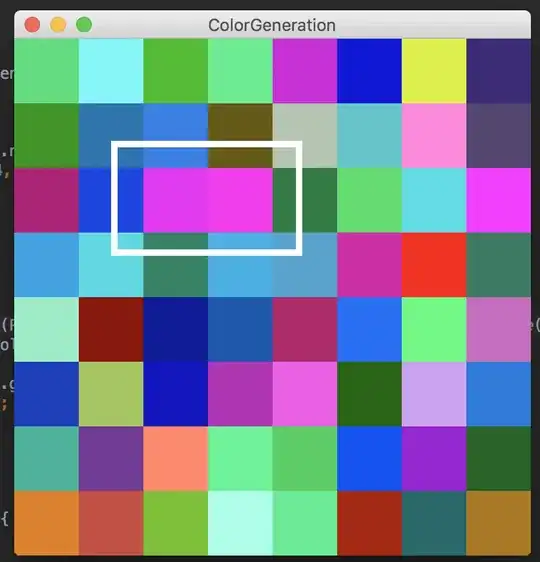

I'm learning some concepts of procedural content generation. Now I'm generating a map with regions and each region has a diferent colors generated in a pseudo-random way.
My problem right now is that most of times (more probably when more regions exists), some regions has colors that are visually similar.
I want to control that adjacent colors are visually different, but still with some random component. What make colors different?
