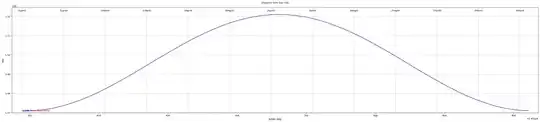

Here's a graph of the distance from the Sun to the Earth (in blue) and to the EMB (in red). The "+1.525e8" means you need to add 152.5 million km to the numbers on the vertical axis. (For reference, the mean radius of the Earth is 6371 km).
Aphelion 9542 BC

Those graphs say that aphelion and solstice occur around midnight on the 5th of March, 9541 BC, or Julian day -1763363.5. Horizons uses the Julian calendar for dates prior to 1582-Oct-15. The equivalent (proleptic) Gregorian calendar date is the 22nd of December, 9542 BC.
