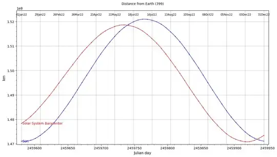

For what it's worth, here's a graph of the distance from the Earth to Sun and to the SSB, for 2022, with a 7 day timestep between the data points.
Distance from Earth to Sun & SSB, 2022 Plotting script from https://astronomy.stackexchange.com/a/49823/16685
Here's a plot spanning 1700 to 2200 (the same timespan as my Sun-SSB plot in the answer linked above), also with a 7 day timestep.
Earth to Sun & SSB, 1700 to 2200

    It would have been better to plot distances over a much longer span of time, tens to hundreds of years, or even longer. The Earth-Sun distance would exhibit an almost sinusoidal behavior while the Earth-SSB distance would have lots of beats. – David Hammen Feb 12 '23 at 16:31
    @DavidHammen Done. But it looks a bit grungy: the Imgur uploader decided that it's too big and converted it to a JPEG. :( – PM 2Ring Feb 12 '23 at 17:07
    But you can see the pattern. The Earth-Sun distance is a nice simple sinusoid with a period of one year. The Earth-SSB distance has beats. Also, clicking on the image shows more detail. – David Hammen Feb 12 '23 at 17:54
