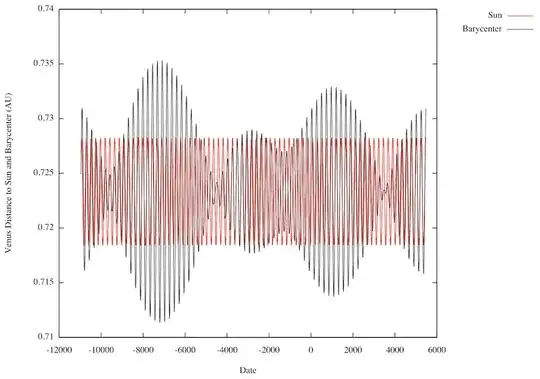

On the other hand, if you want to model the behavior of a single planet, and especially the inner terrestrial planets, it's best to model the planet as orbiting the Sun, with the other planets slightly perturbing the orbit of the planet in question. Stealing from an answer to a related question I wrote on physics.SE, the image below depicts the orbit of Venus about the Sun (red curve) and the orbit of Venus about the solar system barycenter (black curve). The horizontal axis is time in days from noon on 1 January 2000. The vertical axis is distance from the Sun (red curve) and distance from the barycenter (black curve).
Orbit of Venus about the Sun (red curve) vs. orbit of Venus about the solar system barycenter (black curve). See surrounding text.
It's pretty clear from the above graph that it is better, at least for the short term, to model terrestrial planets as orbiting the Sun. Over longer spans of time, the other planets in the solar system perturb the orbit of a terrestrial planet. The greatest of these perturbations is to make the orbit precess. The relativistic precession of Mercury is less than a tenth of the Mercury's non-relativistic precession due to perturbations from other planets.

    Just to drive home the point that the OP was asking about: how much do the perihelion & aphelion distances of Venus (the peaks & valleys of the red curve) actually vary? It's hard to tell from this graph. – Michael Seifert Sep 13 '21 at 13:25
  • @MichaelSeifert The scale goes from 0.71 AU (106.214.488 km) to 0.74 AU (110.702.424 km), so spans 4.487.936 km. For comparison: The sun has a radius of 696.342 km, so the scale is about 3,2 suns wide, so each horizontal segment is (roughly) 1/2 sun disks wide. Does that help? – Angelo Fuchs Sep 13 '21 at 20:06
    @AngeloFuchs: No, I was asking about whether there were any differences between the peaks of the red graph. They all appear to be at about 0.728 AU, and it's hard to differentiate between they on the scale of the graph. The OP's question is specifically about whether there are differences on a planet's distance to the Sun over time due to the effects of other planets; this graph seems to indicate they're small, but I was curious how small. – Michael Seifert Sep 13 '21 at 20:18
  • @MichaelSeifert The aphelia do not differ that much, but the distance to the sun differs by about one solar diameter from aphelion (0,728) to perihelion (0.718). The distance of Venus to the Sun in dependence of the other planets differ marginally and can not be seen on this graph. What can be seen is that the sun (as primary masspoint for Venus) moves noticeably around the barycenter of the solar system and takes Venus with it. So to answer the original question: No, the sun is not (noticeably) closer to earth because of Jupiter. – Angelo Fuchs Sep 13 '21 at 20:45
