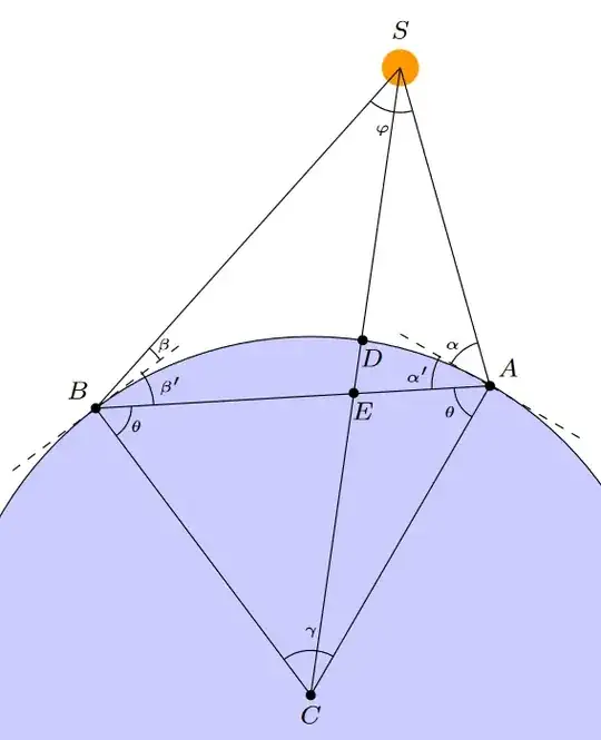

I've drawn a figure in LaTex to explain the system and the measurements needed. The quantity of interest is the length $|CS|$.
Figure 1:
The notations are explained below.
  1. $A$ is the first location on the equator
  2. $B$ is the second location on the equator
  3. $C$ is the center of the earth
  4. $D$ is the intersection of $\overline{CS}$ and Earth's surface
  5. $E$ is NOT NEEDED
  6. $S$ is the position of the sun
  7. $\alpha$ is the angle between $\overline{AS}$ and the Earth-tangent at point $A$
  8. $\beta$ is the angle between $\overline{BS}$ and the Earth-tangent at point $B$
  9. $\alpha'$ is the angle between $\overline{AB}$ and the Earth-tangent at point $A$
  10. $\beta'$ is the angle between $\overline{AB}$ and the Earth-tangent at point $B$
  11. $\varphi$ is the angle $\angle{BSA}$
  12. $\theta$ is the angle $\angle{ABC} = \angle{BAC}$
  13. $d$ is the distance between $A$ and $B$ along Earths surface (NOT IN FIGURE)
  14. $r$ is the radius of Earth (NOT IN FIGURE)
CALCULATIONS
From figure 1, it's evident that $\alpha'=\frac{\pi}{2}-\theta$ and $\beta'=\frac{\pi}{2}-\theta$, so $\alpha' = \beta'$. The triangle $\triangle ACB$ is an Isosceles triangle since two of it's sides have the same length, $|AC|=|BC|=|DC|=r$. Thus $\gamma = \frac{d}{r}$ radians and $\theta = \frac{\pi-\gamma}{2}$. Moreover, $\angle{BAS} = \frac{\pi}{2}-\theta+\alpha$ and $\angle{ABS}=\frac{\pi}{2}-\theta+\beta$, so
$$\varphi = \pi-(\angle{BAS}+\angle{ABS})=2\theta-\alpha-\beta. \tag 1$$
Using the Law of Sines on the triangle $\triangle{ABS}$ we obtain the length $|AS|$ as
$$\frac{\sin{\varphi}}{|AB|}=\frac{\sin{\angle{ABS}}}{|AS|}\Longleftrightarrow |AS|=\frac{|AB|\sin{\left(\frac{\pi}{2}+\beta-\theta\right)}}{\sin{\left(2\theta-\alpha-\beta\right)}},\tag 2$$ where $|AB|$ is found using the Law of Cosines on the triangle $\triangle{ACB}$ as follows
\begin{align} |AB|^2 &= r^2+r^2-2r^2\cos{\gamma} \tag 3 \\ &= 2r^2-2r^2\cos{\gamma} \tag 4\\ &= 2r^2(1-\cos{\gamma}) \tag 5 \\ &\Leftrightarrow |AB|=r\sqrt{2(1-\cos{\gamma})}. \tag 6 \end{align}
It follows that
\begin{align} |AS| &= \frac{r\sqrt{2(1-\cos{\gamma})}\sin{\left(\frac{\pi}{2}+\beta-\theta\right)}}{\sin{\varphi}} \tag 7 \\ &= \frac{r\sqrt{2(1-\cos{\gamma})}\sin{\left(\frac{\pi}{2}+\beta-\theta\right)}}{\sin{(2\theta-\alpha-\beta)}}. \tag 8 \end{align}
Since $\theta=\frac{\pi-\gamma}{2}$ we can rewrite equation $(8)$ as
$$|AS|=\frac{r\sqrt{2(1-\cos{\gamma})}\sin{\left(\frac{\pi}{2}+\beta-\frac{\pi-\gamma}{2}\right)}}{\sin{\left(\pi-\gamma-\alpha-\beta\right)}}. \tag 9$$
At this stage, in triangle $\triangle{ACS}$ we have expressions for the side length $|AS|$ as well as the angle $\angle{CAS}=\frac{\pi}{2}+\alpha.$ We can now calculate the length of the line segment $|CS|$ using, again, the Law of Cosines. It follows that
\begin{align} |CS|^2 &= |AS|^2+r^2-2|AS|r\cos{(\triangle{CAS})} \tag {10} \\ &= |AS|^2+r^2+2|AS|r\sin{\alpha} \tag {11} \\ &\Leftrightarrow |CS| = \sqrt{|AS|^2+r^2+2|AS|r\sin{\alpha}} \tag {12}. \end{align}
Equation $(12)$ is the complete formula for calculating the distance $|CS|$ which is the sought distance. This expression is expressed in terms of the constant parameters $r,d$ and the solar altitude variables $\alpha,\beta$. We can therefore write the solar distance as a two dimensional function of $\alpha,\beta$ as
$$\boxed{f(\alpha,\beta) = \sqrt{|AS|^2+r^2+2|AS|r\sin{\alpha}},} \tag {13}$$
where
$$|AS|=\frac{r\sqrt{2(1-\cos{\left(\frac{d}{r}\right)})}\sin{\left(\beta+\frac{d}{2r}\right)}}{\sin{\left(\frac{d}{r}+\alpha+\beta\right)}}.\tag{14}$$

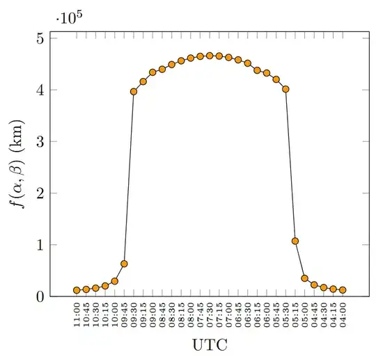

Below, the computed distances are plotted in a graph with varying UTC timestamps.
Figure 2:
Conclusions & Questions
Clearly my results differ a lot from today's accepted 1 AU. The distances are symmetrical around 07:30 UTC and there is a lot of variation, from roughly 12 000 km to 466 000 km. I want to explain why this is. I've listed some potential error sources:
  1. Error in my calculations. However I want to believe that they are all correct unless I'm missing some detail. I've also asked 2 other people with math knowledge to verify the derivation and none of them could find any error.
  2. Angular measurements and their precision. The accuracy of the angles of elevation (alpha and beta) is crucial. Small errors in angle measurement can lead to large errors in the calculated distance. This is especially true for trigonometric functions, which can vary significantly with small changes in the input angles. This I can't verify since I do not know how these angles were measured but at least they are given with two decimals. Could a slight variation/error in these cause the distance to jump from 12 000km to 150 000 000 km? Even if there are minor errors in the angles, it seems far fetched and quite unbelievable that the distance should suddenly drop down to 0.00008 %. If this is the case, I'd want to know how.
  3. Atmospheric refraction. However accounting for this, the distances computed should be closer since the perceived position is further away (larger solar angle) than the true position and the $\alpha,\beta$ are calculated based on the perceived position according to the website. So atmospheric refraction can't be the answer to the large discrepancy.
Eventually, my question boils down to: why are my results so far away from 1 AU?

For the first hour and the last 75 minutes, it appears you neglected to take into account the direction of the Sun. As shown on this first image, enter image description here you are measuring the Sun as if it were along the black line stemming out of the top point; this will give a Sun at the intersection of the two black lines, which is about 12473.79 km away from the bottom point, indeed. But the Sun is then not in the direction of the black line, but in the direction of the red line. As you can see, it is very nearly parallel to the black line from the bottom point at that moment.
For the “middle” part of your experiment, let’s say from 5:30 to 9:15, there must be something wrong in your coding or formulas, as the following graphic, simulating the situation, shows the direction of the Sun from one location is parallel to the direction of the Sun from the other location. (Click on image to enlarge it.) enter image description here

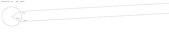

In both drawings, the dashed grey lines are the local horizons.

    @Parseval: The angle between A and B in both of my figures is (102-38) = 64°, from the values you give. I used Adobe Illustrator. – Pierre Paquette Mar 17 '24 at 10:09

  • The calculators don't figure the Sun's distance, making it impossible even in theory.
The calculation is numerically ill-posed, and each of these sources of error individually doom the calculation to failure—so together they are more than sufficient. Some of them are easy to fix (e.g. using the better radius), and some are not (fixing NOAA's calculator).
We can fix the errors related to the setup, and instead of trying to use the calculators (which aren't in the spirit of an actual "terrestrial measurement" anyway), we could imagine trying to do a real-world measurement. One would need two very accurate telescopes taking a somewhat difficult measurement exactly at the equinox on the equator (or correcting for any differences mathematically). Technologically I think it's at the edge of feasible.
