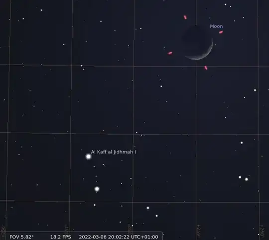

The steepest angle in 2022 was indeed a few days ago and a month ago, at -59°:
moon pointing down at sunset in march

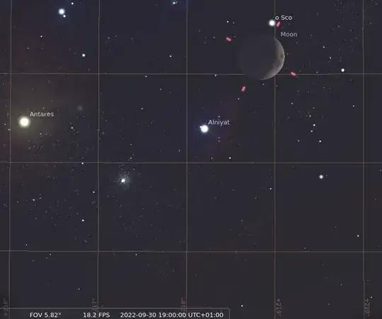

The flattest angle will be in September, at -12°:
moon pointing to the right at sunset in september

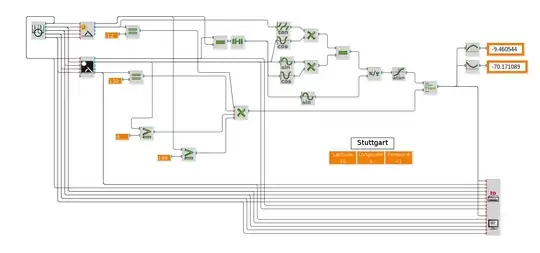

Code
If you're interested, here's the "code" I used to calculate the moon tilt. The program was written in INSEL, which is similar to Simulink:
INSEL model for moon tilt
Another, possibly easier way would be to use Astropy or PyEphem.
