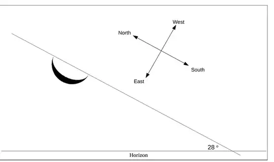

Can it be shown mathematically that the line connecting tips of crescent is parallel to the North-South line and the line gives latitude of the plane ( When the Moon is sufficiently close to the horizon, we can approximate the surface of sky as a simple plane.)
Sources :
https://olympiads.hbcse.tifr.res.in/wp-content/uploads/ino20/INAO2020-Solutions-20200204.pdf
https://www.naturalnavigator.com/find-your-way-using/moon/
