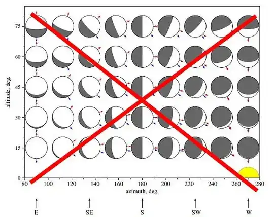

The following paper The Moon Tilt Illusion by Andrea K. Myers-Beaghton and Alan L. Myers takes us through perspective projection to show that when the Moon is much further away from the Sun this doesn't work as well, but for the purposes of this answer about a thin crescent Moon it's perfectly fine to assume the Sun is in the direction where the bright side of the Moon suggests it is.
Figure 11. Moon tilt illusion for waning phases in northern hemisphere. Sun is rising due east. Red line is observed slope and blue line is expected slope of moon-sun line. Azimuth measured CW from north.

  • -1. The shadow of the Moon does necessarily not point toward the Sun as seen from the Earth. I'll add a reference shortly. – David Hammen Feb 26 '22 at 21:35
    Reference: https://www.seas.upenn.edu/~amyers/MoonPaperOnline.pdf . See figures 10 & 11. – David Hammen Feb 26 '22 at 21:45
    @DavidHammen you know darn well that in this situation it's very close. I've updated and added the U Penn paper, it's a beauty! – uhoh Feb 27 '22 at 00:40
    @DavidHammen Your very reference proves that, with the illuminated side of the crescent pointing to the left, the photo could only have been taken at sunset in the southern hemisphere (which the author denies though). Otherwise, it must have been taken at sunrise or the photo has been flipped around. – Thomas Feb 27 '22 at 09:39
  • @Thomas The only time one can see that thin of a crescent Moon is very near sunrise or sunset. What I was disputing was the line toward the Sun. That that line doesn't always work is something flat earthers love to use as "evidence" in favor of their nonsense. It is evidence -- evidence of 3D projective geometry. – David Hammen Feb 27 '22 at 09:50
  • @DavidHammen There is no odd projective geometry effect visibile here. The crescent points in a direction below the horizon as you would intuitively expect it. But if this is a sunset photo taken in the northern hemisphere, the crescent must point towards the right, not the left. – Thomas Feb 27 '22 at 10:17
  • @Thomas That the crescent moon always points to the right at sunset in the Northern Hemisphere is incorrect. The Moon's orbit is inclined with respect to the ecliptic by 5 degrees. – David Hammen Feb 27 '22 at 10:41
  • @Thomas I think David means this effect. The Moon's lit side only points "correctly" to the sun when lunar phase is 50%, so that it "looks" exactly to the side. – Ruslan Feb 27 '22 at 16:25
  • @Ruslan We are not talking about pointing exactly in the direction of the sun, only pointing approximately in its direction or approximately opposite, It should do the former, but if this were a sunset it would be the latter, which is impossible, – Thomas Feb 28 '22 at 08:31

Based on these insights, one can conclude that, if your picture was taken in the northern hemisphere, it must actually have been taken at sunrise (not sunset as it claims). This is because because the Sun and Moon are both moving from East to West, which means in the northern hemisphere from left to right. So if your photo would be a sunset photo, the crescent would be moving from the top left to the bottom right. The Sun would have already done that and would be ahead of the crescent below the horizon. So the illuminated side of the crescent should broadly point to the right. But it is in fact broadly pointing to the left, which means the crescent was rising from the bottom left to the top right, with the Sun about to rise behind it.
This is also confirmed by the figures in the scientific publication mentioned in some of the comments here. The possible phases at sunset are not consistent with the photo at all

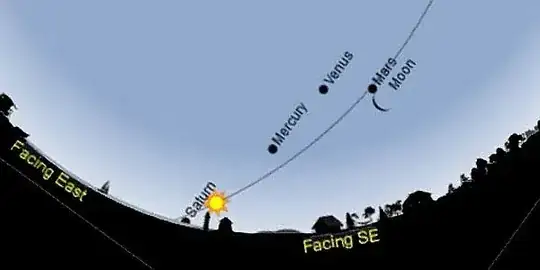

Here are the sunset/moonset and sunrise/moonrise views visible from Albuquerque, New Mexico around New Moon on 1 Feb. 2022 (courtesy of Sky and Telescope Skychart )
Sunset 3 Feb. 2022 Sunset 3 Feb. 2022
Sunrise 29. Jan. 2022 Sunrise 29. Jan. 2022
And below again the photo taken by the OP (obviously showing the scenario slightly later/earlier than the charts, with the Sun below the horizon)
So if the photo indeed taken at around the last New Moon (which is not confirmed by the OP as yet) it could only have been taken at sunrise not sunset. The chart shows a few planets near the Moon on this occasion as well, but they may have been too close to the horizon to show on the photo given the probably shortish exposure time. If that would be a sunset photo, the illuminated side of the crescent would not only point opposite to the sun (which is impossible, and which I have never seen in 50+ years observing the sky) but it should have been considerably higher in the sky as well)

  • @JohnHoltz See the added skycharts in my answer, which prove as well, that this can only be a sunrise photo – Thomas Mar 01 '22 at 22:08
