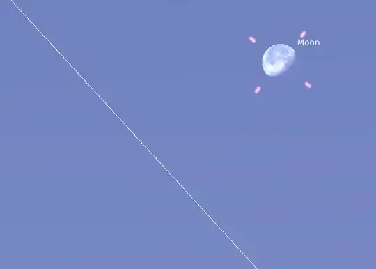

Since both the sun and moon are on (or near) the ecliptic, which is a great circle in the sky, the lit part of the moon should point in the direction of the ecliptic. The two images below confirm this.
This image shows the moon and the sun on the ecliptic. While it appears curved in this projection, it is in fact a straight line in the sky.
This shows the lit part of the moon points in the direction of the ecliptic, and so straight towards the sun.
Images from Stellarium
