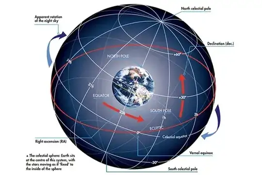

Celestial coordinate system
Image from A guide to celestial coordinates
Celestial coordinates are a form of spherical coordinates where the axis are right ascension (the equivalent of longitude) and declination (angle from the celestial equator).
After performing some spherical trigonometry the expression for Angular Distance Between Two Points on a Sphere is found to be: $$\Psi = \arccos\left(\sin\theta_1\sin\theta_2 + \cos\theta_1cos\theta_2\cos(\phi_1-\phi_2)\right)$$ where $\Psi$ is the angular separation, $\phi_1$ and $\phi_2$ are the right ascensions of the first and second direction, and $\theta_1$ and $\theta_2$ are the declinations of the first and second direction.
This same expression can be applied to any spherical coordinate system, regardless of the location of the poles. You will need to be careful to identify the equivalent of the right declinations and declination, and also be aware of if angles are measured from the equator or the poles.
