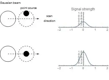

A common technique to estimate the beam position on the sky are so called pointing measurements. Ideally you try to use a radio point source with a known position on the sky. Scanning this point source with your radio beam will give maximum signal strength once the beam is centered on the object. By doing this for example as a cross-scan you are trying to establish the detailed angular position of the max. signal strength.
There are some problems involved. First of all, there are not too many radio point sources on the sky (depending on the frequency you are measuring). Maser emission is usually a good candidate. But for higher frequencies the list becomes very short. A commonly used pointing source for carbon line emission receivers is the carbon star IRC 10216. Also planets are used as pointing sources, because they are effectively point sources for most of the non too big telescopes. Depending on the frequency they are suffieciently radio bright to be used.
You can also point on extended objects where you know the shape exactly, e.g.
cross pointing at the stellar or lunar disk is also used.
Usually these pointing measurements have to be performed at multiple elevations to establish a good model of the pointing. This is for example because the radia antennas suffer from gravitational deformation depending on the elevation they are looking at (they are not infinitely stiff structures). The also suffer from thermal expasion, wind pressure, etc. (See for example : http://ipnpr.jpl.nasa.gov/progress_report/42-159/159A.pdf , and http://lss.fnal.gov/archive/other1/iram-298.pdf )
All these techniques depend on the visibility of the pointing sources. An alternative is the usage of an optical guiding telescope that is attached to the radio telescope. Here you use optical star positions to determine your pointing. Then you just have to establish the relative alignment between the optical axis of the optical telescope and the radio beam. This of course requires the visibility of stars, i.e. you can use it only during night observations ( while sun pointing is used during day time). The Herschel satellite used an optical guide telesope (pointing in the opposite direction) to point the telescope. ( see here: http://herschel.esac.esa.int/Docs/Herschel/html/ch02s04.html)
