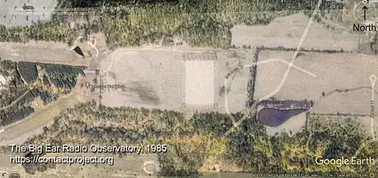

24h x 60 min = 1440 mins/day = 86400 sec 360° / 86400 = 0.0041° per second 72 seconds = 0.3°
An arcminute (denoted by the symbol '), is an angular measurement equal to 1/60 of a degree or 60 arcseconds. To convert a degree measurement to a minute of arc measurement, multiply the angle by the conversion ratio. The angle in minutes of arc is equal to the degrees multiplied by 60.
0.3 x 60 = 18 arcminutes?
As seen from the Earth, the Sun and Moon both have angular diameters of about 30 arcminutes. The full moon's average apparent size is about 31 arcminutes (or 0.52°).
In other words, the Wow! signal spanned an area of about half the size of the Sun or the Moon, in the sky. enter image description here
That is a rather large area in astronomy.
