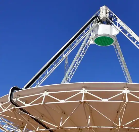

Dish with a focal plane array
Some radio telescope dishes are equipped with an array of receivers, analogous to a CCD array of pixels on an optical telescope, though much fewer pixels.
In this case the half-width of the field of view (in radians) is the half-width of the focal plane array divided by the effective focal length there, or more precisely the arctangent of that ratio.
For more on that see:
- What is the highest granularity focal-plane array on a dish radio telescope? Or is this the ONLY ONE?
- How do ASKAP's focal plane phased array feeds interact with the entire array phasing?
