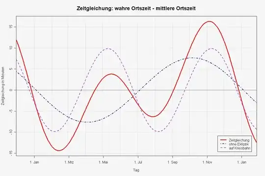

That graph in the question was created using simple EoT equations (see here for details), similar to my graphs here, which were created using the crude equations from Wikipedia, for the year 2000.

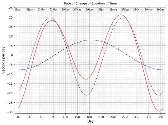

Here's a graph of the rate of change of the EoT and its components for the year 2000, created by differentiating the crude equations from Wikipedia. It clearly shows that the obliquity has much more influence than the eccentricity does on the change in solar day length.

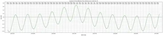

Here's a plot of my EoT values minus Horizons' values, using a 1 day step. As you can see, the difference is less than 1 second.
Hughes minus Horizons Eot
