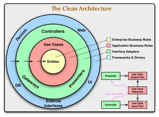

Here's an onion diagram.

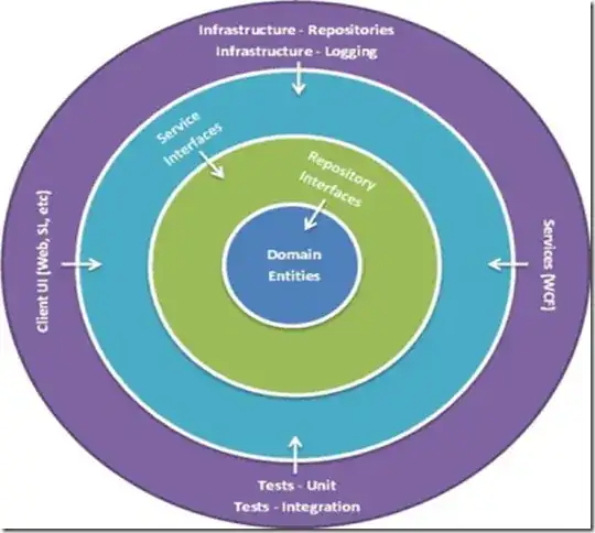

It's not that much different from this:
But this one shows the flow of control in and out of layers. Note the purple arrow in the lower right corner. That's important here because the flow of control dictates the order of construction if your objects are immutable.
The Controller
can call the Use Case Interactor
which can call the Presenter
. To do that they need references to what they call. That's what they know. Those references only exist once those objects have been constructed. So what must be constructed first? The last object in the flow of control.

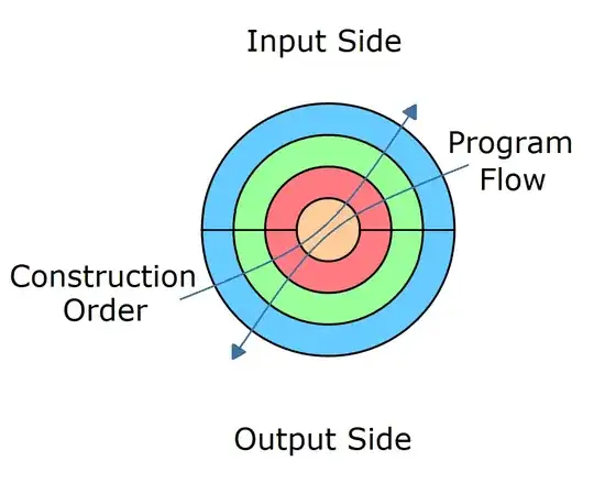

If we diagram the construction so it can be visualized with the flow of control it might look like this:
I've separated the layers based on the order in which persistent immutable objects can be built due to their dependencies. Once built that horizontal line dividing the layers in two is no longer needed. But if you want immutable objects then this is required so that everything gets the references they need so they can talk.
