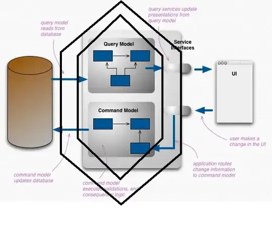

This is like asking if you can use utensils to eat ice cream. (Yes you can. I recommend a spoon.)
CQRS asks you not to mix together the complexity needed to perform queries with the complexity needed to update.
Hexagonal Architecture asks you not to mix the complexity of your input and output ports with your central application logic.
So yes you can do both. But doing one doesn't mean you've done the other.
If you did, it could be diagrammed like this:
That shows where things go. Imagine adapters between the hexes that help isolate the central application logic from DB and UI changes.
Many of these fancy principles are really just about isolating things. It's not that you can't make something that works if you ignore them. But following them means the impact of a requirements change is isolated. It doesn't make it easier to write the code nearly as much as it makes it easier to maintain the code.

The result is still fundamentally hexagonal; for instance, if you are implementing a stateless service, command and query requests will still pass through a primary port to the domain model, which fetches the data from the external persistence component using a secondary port. The key idea is that reads will be collecting data from a different secondary port than the one used for writes.
If you weren't using CQRS, then your reads and writes would likely be sharing the secondary port.
