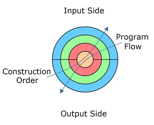

Now, with that in mind, the arrows in these diagrams show what knows about what. To know about something you either build it or get handed a reference to it.
Sure, that last one is an injection. But just because you know about something doesn’t mean it returns anything to you when you call it. Some things you call and just trust that it’ll deal with what you told it to do.
This can lead to the flow of control going off on a life of its own.
Which means you don't have to worry so much about flow of control when constructing the clean architecture onion. This is thanks to DiP
What you should worry about is that things must exist before you can shove them into other things:
enter image description here My DI pattern for constructing immutable persistent objects in CA
If that’s what you mean by “inject domain services directly into the infrastructure layer” then sure. To call something you need a reference to it. But that isn’t moving the business logic. That’s asking the business logic to do its thing.
Uncle Bob doesn’t talk that much about construction or DI in his books. His diagram is about what he wants once construction is done. If you want to read more about Dependency Injection I recommend Mark Seemann

  • Thanks for your detailed response. My solution for that is to use a domain services using DI in the infrastructure layer so that it will use it to pass the data to the domain service to process the incoming data from the various comm protocols. The infrastructure layer is not processing any logic it just pass what it gets to the domain service to process it. So basically, It will treat the domain services Hi take incoming data.... Hey Give me outgoing data and that's it. That will happen in any type of comm protocol implemented in the infra layer. Is that considered a violation to the arch?. – Shady Shahin Jan 04 '24 at 23:52

  • @candied_orange's latest diagram shows the program flow well, you come in on the infra layer with the IncomingClient, run the domain layer DataProcessor, then go out again on the Infrastructure layers OutgoingClient – Ewan Jan 04 '24 at 19:56
