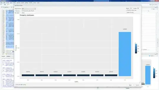

There are implementations for Grover's algorithm with an oracle for $n=3$ searching for |111>, e.g. (or see an R implementation of the same oracle below): Oracle for 111 https://quantumcomputing.stackexchange.com/a/2205

 result=measurement(n3)
 plotMeasurement(result)
