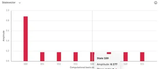

3-qubit single application of $|000\rangle$ inversion and amplification:
For multi-iterations, the $|000\rangle$ coefficient sign must be inverted again first each time, before applying the amplification.

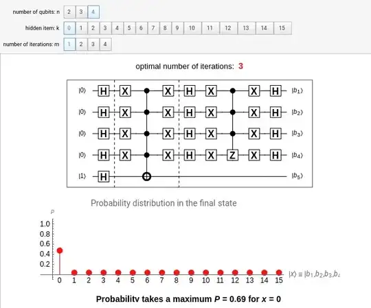

4-qubit single application of $|0000\rangle$ inversion and amplification:
