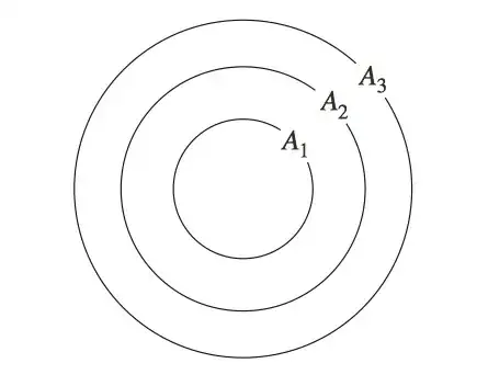

one of the best ways to get an idea of how to proceed is to look at drawings of sets.
Let's look at the example where $A_1\subset A_2\subset A_3\subset A_4\subset\cdots$ (continuity from below). One can represent these sets graphically as (only $A_1,A_2,A_3$ are drawn): Drawing1

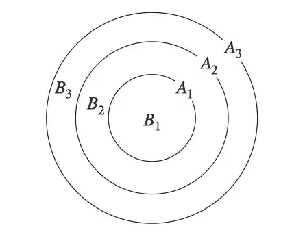

Suppose that we define sets $B_1,B_2,B_3,\ldots$ as $$B_1=A_1\\ B_2=A_2\setminus A_1\\ B_3=A_3\setminus(A_1\cup A_2)\\ \ldots\\ B_n=A_n\setminus(A_1\cup\cdots\cup A_{n-1})\\ \ldots,$$ and so on. Graphically, this would look like: enter image description here
Then, it seems intuitive enough that the union of every $A_i$ up to $n$ and the union of every $B_i$ up to $n$ are the same for every $n$, and that the $B_i$ are disjoint (though one still needs to demonstrate this rigorously). With this in mind, the solution should become clear (hint: use countable additivity).
