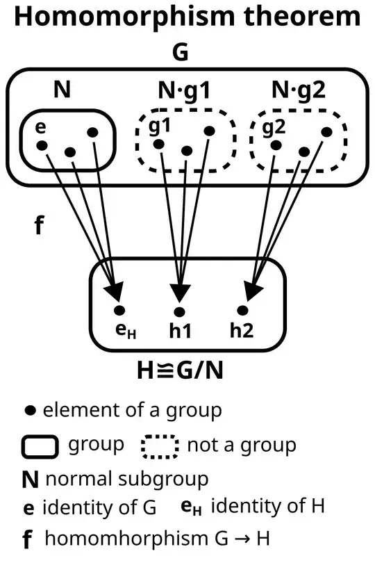

Here is a simplified diagram which illustrates the theorem, which tells us that every homomorphism looks like this:
where:
  • f is an homomorphism from G to H
  • N is a normal subgroup of G
  • H = G/N is the image of f, also known as the "quotient group"
  • e is the identity element of G
  • $e_H$ is the identity element of H
  • h1 and h2 arbitrarily selected non-identity elements of H
  • g1 and g2 are any arbitrarily selected elements such that $f(g1) = h1$ and $f(g2) = h2$.
    Since an homomorphism is not necessarily bijective, there are in general several possible choices for $g1$ and $g2$ with that property.
  • f maps N to $e_H$, $N \cdot g1$ to h1 and $N \cdot g2$ to g2
  • $N \cdot g1$ and $N \cdot g2$ are two cosets of N when it is multiplied by g1 and g2 respectively.
    $N \cdot g1$ contains all elements $g$ such that $f(g) = h1$.
  • each coset corresponds to one of the elements of H which they map to: N
  • we see that N is the kernel of f by the definition of kernel, because N is the inverse image of $e_H$
  • from this it is clear how the structure of the quotient G/N is simpler than the original G: we collapsed the structure of the entire normal group N to a single point! Therefore, an homomorphism is basically a simplification function that ignores the structure of the normal group while doing its transformation

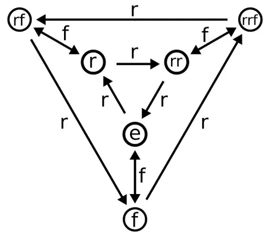

This is the group of rotations and flips of a triangle. It has 3 rotations, with 2 flips states each, so 6 elements in total. Here's a Cayley-like graph of it:
SVG source.
Legend:
  • r: clockwise rotation
  • f: flip
This is the smallest non-Abelian group, so we might expect to see some more interesting behavior, because every Abelian group is just direct product of cyclic groups, and in $G = H \times I$, both $H$ and $I$ are normal in $G$, so everything is simple and boring.

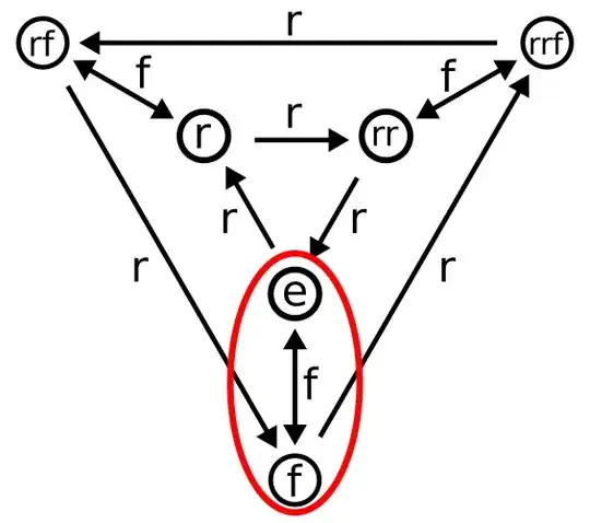

Now it is instructive to try to create a homomorphism with non-normal $C_2$ subgroup and see how it fails, as that gives an intuition on why we need a normal subgroup to create an homomorphism.
You will notice that it fails because the rotation on flipped elements happens in inverse direction! The inner triangle are the unflipped rotations, and the outer triangle the flipped ones. When rotations are applied, the inner and outer spin on opposite directions.
We can try that pictorially first. To start with, for sure the normal subgroup will be the kernel:
Now, we have to find a way to create two more groups of two elements that will map to the two other elements of the image.

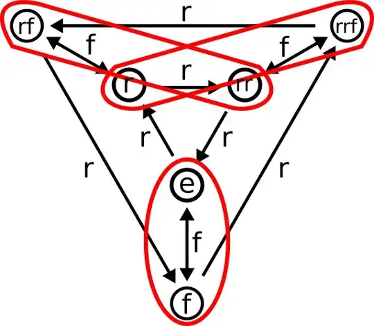

We could be tempted to select:
but that doesn't work! E.g. if we apply:
  • r to r, it goes to rr
  • r to rf, it goes to f, which is in the equivalent class of the identity, so another equivalence than rr!
Therefore, we see that we can't make the homomorphism like that, as it won't be distributive over the domain's operation.

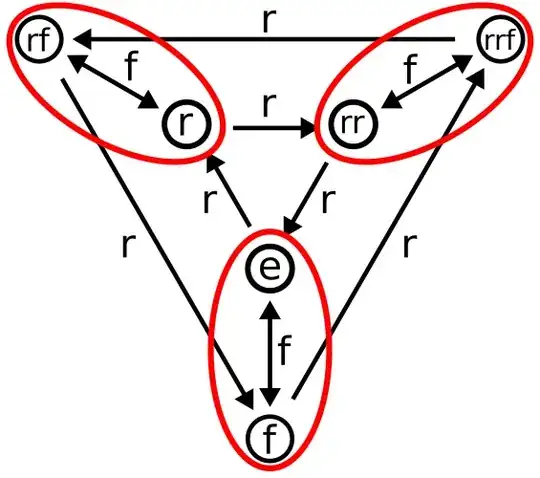

Let's try another one:
Hmmm... that one seems to work, why is that? The reason is that we had previously only checked the Cayley graph where the arrow r moves x to xr, i.e. a transformation after.
If we take the other graph, of the "transformation before" operation, then our second choice fails there because the graph is a bit different:
and so our attempt fails like the previous one:
e
and there is no choice that works for both.

You might be tempted to take the direct product of groups as a definition of multiplication, but that alone is not very satisfactory, because as mentioned at When is a group isomorphic to the product of normal subgroup and quotient group?, you would be missing out many corresponding non-trivial "divisions" (homomorphism/quotient).
A slightly better choice would actually be a semidirect product, because the direct product generates a larger group of which both smaller groups are necessarily normal (because of the trivial projection homomorphism), and the semidirect product only needs one of them to be normal. But it is still not general enough.
If we were able to do group extensions algorithmically, then we would able to classify all finite groups, because we have already classified the simple ones.
See also: How is a group made up of simple groups?

The normal subgroups of $G$ are all the sets, which appear as kernel of group-homomorphisms $G \rightarrow H$.
Subgroups are the sets, which appear as images of group-homomorphism $H \rightarrow G$.
