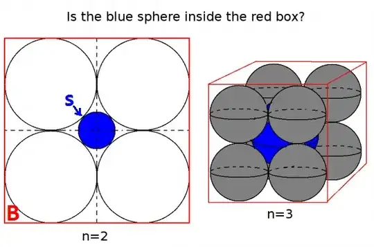

Here's a counterintuitive example from The Cauchy Schwarz Master Class, about what happens to cubes and spheres in high dimensions:
Consider a n-dimensional cube with side length 4, $B=[-2,2]^n$, with radius 1 spheres placed inside it at every corner of the smaller cube $[-1,1]^n$. Ie, the set of spheres centered at coordinates $(\pm 1,\pm 1, \dots, \pm 1)$ that all just barely touch their neighbor and the wall of the enclosing box. Place another sphere $S$ at the center of the box at 0, large enough so that it just barely touches all of the other spheres in each corner.
Below is a diagram for dimensions n=2 and n=3.
Does the box always contain the central sphere? (Ie, $S \subset B$?)

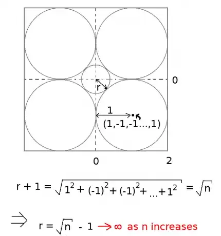

Surprisingly, No! The radius of the blue sphere $S$ actually diverges as the dimension increases, as shown by the simple calculation in the following image,
calculation of inner sphere radius
The crossover point is dimension n=9, where the central sphere just barely touches the faces of the red box, as well as each of the 512(!) spheres in the corners. In fact, in high dimensions nearly all of the central sphere's volume is outside the box.

    But the volume of the box diverges just as well. As you increase dimensions shouldn't you expect everything to just keep growing? – Steven-Owen Nov 03 '12 at 17:02
  • This is not counterintuitive, one can see what happen comparing cases $n=2$ and $n=3$, relative difference in volumes between blue sphere and box is less.
  • $2^n$ spheres always has radious 1 when diagonal of box increases.
  • The fact that a sphere bounded by the vertex of a box can get out of the box in any dimension.
  • 3 facts that makes this result perfectly logic!.
    – Gaston Burrull May 05 '13 at 06:48
    @Steven-Owen but notice that the distance from the origin to the center of each cube face remains constant. – Thomas Ahle Jan 06 '14 at 08:19
    This example shows how important is that we think outside the box! :-) – Asaf Karagila Jan 05 '15 at 16:16
  • The alignment from n=2 to n=3 is different. I am trying to imagine the alignment in n=4 and above. – Xonatron Dec 20 '18 at 05:18
