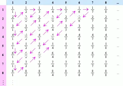

Suppose for a moment that we look at the $\epsilon = 1/8$ covering, so that at most $1/2$ of $[0,1]$ is covered. Suppose we also that our enumeration of the rationals is the standard one of Cantor, i.e.
http://www.homeschoolmath.net/teaching/rationals-countable.gif
It might be easier if we don't remove duplicates (still a proof of denumerability) so that we know the general $n^\text{th}$ number easier.
Then my question is: can we explicitly find an irrational not covered by one of the $\epsilon$-balls? Perhaps it's deceptively easy. Can we find many?
