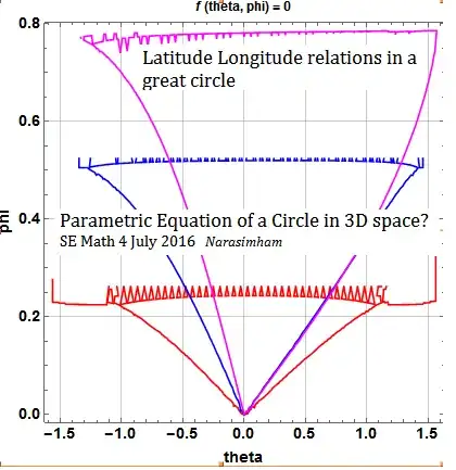

Using standard spherical coordinates for a sphere surface $( a,\theta,\phi)$ we have parametrization for axis on z-axis:
$$ (x,y,z) = (a \cos \phi \cos \theta +h, a \cos \phi \sin \theta+k, a \sin \phi+l) $$
for a sphere whose center is displaced from origin to $(h,k,l).$
A great circle is formed by intersection of an inclined plane through sphere center inclined at angle $\alpha$ to z-axis.
To choose a great circle on the spherical surface we have to find a relation $f(\theta,\phi)=0. $
An implicit function relating $ \theta,\phi$ for great circle is given as:
$$ \cos \phi \tan \alpha = \sin \theta \sin \phi + \frac{\cos \theta \sin \alpha}{\sqrt{\cos^2 \phi - \sin ^2 \alpha}} $$
It is found from conditions imposed for planar / zero torsion condition and geodesy condition. Proper sign to be chosen depending on which octant we are in. Sketched in Mathematica ContourPlot for three inclinations $ (45^0, 60^0, 75^0).$
Euler rigid body rotations are to be applied by matrix multiplication for direction cosines of given axis.
SphereGrtCircleLat&Long
