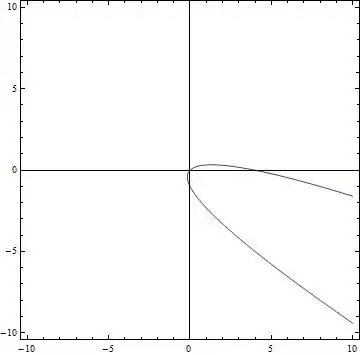

and indeed your parabola looks like
para
The thing here is that we actually don't need $\theta$ itself but rather we need $\sin(\theta)$ and $\cos(\theta)$ to "undo" the rotation. We can get the exact values without computing $\theta$ itself by drawing a triangle and using half-angle identities

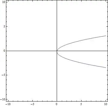

Continuing this example, the sideways parabola looks like this.
It is very slightly shifted and scaled. I leave the rest of algebra up to you. After you find everything you need, for some of them you will need (call this set 2)
$$x' = x\cos(\theta)+y\sin(\theta)$$ $$y' = -x\sin(\theta)+y\cos(\theta)$$
to go back to the original coordinate system.
To go from $(x',y')\rightarrow (x,y)$ use set 1. To go from $(x,y)\rightarrow (x',y')$ use set 2.
