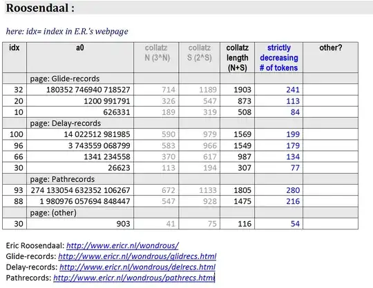

    The collatz-transformation should give an upper limit for the trajectory-length (or: number of *2and \3) I get for $a=1435$ the value $\rho=26$ in my notation and $\lambda=78$ Having $\rho=26$ my algorithm has really to chew... To work one time to $\rho=16$ alone needs a couple of seconds, and the searchspace grows exponentially with linearly increasing $\rho$, so ... I'm waiting on the result of my program... ;-) – Gottfried Helms Jan 12 '21 at 12:39
    Ok, 260 seconds for searching with $\rho=16..26$ ... The first found trajectory is [1435, 4305, 12915, 38745, 116235, 174353, 130765, 49037, 18389, 431, 1293, 485, 91, 273, 205, 77, 29, 11, 17, 13, 5, 1] with $\rho=21$ and $\lambda=65$ and vector of exponents $A=[0, 0, 0, 0, 1, 2, 3, 3, 7, 0, 3, 4, 0, 2, 3, 3, 3, 1, 2, 3, 4]$ and vector of residues $R=[0, 0, 0, 0, 1, 1, 1, 1, 1, 0, 1, 1, 0, 1, 1, 1, 1, 1, 1, 1, 1]$ (see my second posting) – Gottfried Helms Jan 12 '21 at 12:43
  • Do you find any decomposition of 4535? It must be of length at least 76, whereas all numbers lower than it have a decomposition of length no longer than 71, according to my code. – Matthieu Latapy Jan 12 '21 at 13:51

    The number $4535$ is beyond my current resources, while the numbers $4530 \cdots 4534 , 4536 \cdots 4538$ all have an optimal $25$ operations. – Han de Bruijn Jan 13 '21 at 15:51
    Matthieu - while my confirmation confirms $ #(4535)=77$ I was not correct in that the sequences of $2$,$3$ are equal. It is difficult to follow that sequences and compare correctly. But we can see the differences more easily when we look only at the convergents at ends of pairs $222...2;;333...3 $. Your and my decompositions compared give the trajectory $$ your: [1, 10, 11, 58, 274, 182, 1615, 4306, 2551, 4535] \ mine: [1, 5, 11, 29, 77, 91, 511, 1211, 1435, 2551, 4535] $$. The second trajectory (mine) shows the "strictly decreasing" property (when read from left). How did you found yours? – Gottfried Helms Jan 14 '21 at 12:19

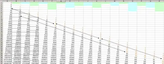

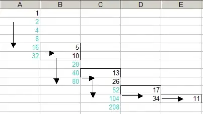

To get a better overview in the possibilities of finding an optimal representation the following picture :
Here we may start at the left column, with some power of 2, and walk right for the $ /3$ steps, until $2$ or $1$ occurs. If we assume, that this process covers all natural numbers, it might be the best strategy for getting a shortest trajectory for any number $N$. If we count the steps down and then steps right towards some number $N$ as length of the trajectory, it seems that lengthes towards some duplicates (for some small $N$ visible in the more rightpart and colored orange) are always longer. To help intuition I placed duplicate indicator lines for the values $N=8$ and $N=42$ in the picture.
For the question of whether all numbers are covered by this scheme I brute force sorted all occuring intermediate values smaller than $1000$ and using the first $120$ rows of the table I got the following list of occuring numbers $N$ (the smaller part of them occur multiple times):

But I think it is not too difficult to prove that the infinite table indeed covers all natural numbers.
Looking at the solutions in @HandeBruijns's answer, for instance $N=11$, he has a much better/shorter representation. Applying the principle of my scheme to them, for instance for $N=11$ I can make this route:
and it indicates, that likely we need the look to the right of the table far more than possible in the image of that small segment of the first table.

Here I've applied my "strictly decreasing" algorithm on some example numbers $a_0$ taken from Eric Roosendaal's Collatz-pages. I think that are well "complicated" numbers: record holders for glide-, delay- and path- records; and the "strictly decreasing" algo can handle numbers with dozens (or likely hundreds) of digits. The trajectory-length of the "strictly decreasing" algo is in all cases drastically shorter than the original Collatz-trajectory. On one hand there are examples where the "strictly decreasing" decompositions are not optimal, but they might be the best systematic approach available when decomposition length becomes large and memory and/or computation time becomes galactic when full combinatorical brute force is no more applicable. (This reminds me, btw., of the problem of "perfect rulers" and "optimal rulers", I think in Wikipedia is an entry)
I give the table not in mathjax because I'd like to have colors etc, and that's not my expertise... So here is a jpeg of the table, and below the raw data.
Roosendaal :
here: idx= index in E.R.'s webpage
idx   a0                  collatz  collatz   collatz    stric dec       optimal??
                           N (3^N)  S (2^S)  length(N+S)# of tokens
      page: Glide-records
32    180352746940718527    714       1189      1903        241
20            1200991791    326        547       873        113
10                626331    189        319       508         84
      page: Delay-records
100   14022512981985        590        979      1569        199
96     3743559068799        583        966      1549        179
66        1341234558        370        617       987        134
30             26623        113        194       307         77
      page: Pathrecords
93  274133054632352106267   672       1133      1805        280
88    1980976057694848447   547        928      1475        216
      page: (other)
30           903             41         75       116         54
Eric Roosendaal: http://www.ericr.nl/wondrous/ Glide-records: http://www.ericr.nl/wondrous/glidrecs.html Delay-records: http://www.ericr.nl/wondrous/delrecs.html Pathrecords: http://www.ericr.nl/wondrous/pathrecs.html
