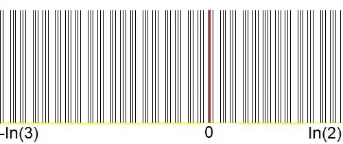

So what we have is a bunch of fractions, all different, but they must fit within the interval $\,]r/3,2r[\,$. This means that the fractions become crowded. Let's make a picture of the iteration process, logarithmic version. The red line is given by $\,\color{red}{\ln(3)y=\ln(2)x-\ln(r)}\,$, small circles are fractions, mapped on a grid $\,m/n \to (m,n)\,$, massively black filled dots are the fractions in the iteration process, while increasing $m$ and $n$ with increments one at a time. The iterations domain is limited by: $\,\color{blue}{-\ln(2)\lt\ln(3)y-\ln(2)x+\ln(r)\lt\ln(3)}\,$. In our case $r = 100$. Mind the sequence at the start.
So it seems that there must be quite some fractions nearby the red line, rerpesenting the real number $r$ in question.
How can we be sure about this? Let's make picture of the crowding of the approximations $a$ in the interval $\,]r/3,2r[\,$, logarithmic scale: $$ a = m\ln(2)-n\ln(3)-\ln(r) \quad \mbox{with} \quad -\ln(3) < a < \ln(2) $$ The red line is where $a = 0$, the desired value.
Further numerical/graphical experiments reveal that the distribution of the fractions seems to be uniform. While seeking further confirmation of this we have done the following, speaking in terms of (Delphi) Pascal:
