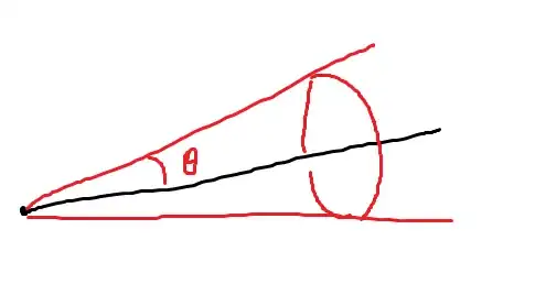

I have a normalized $3D$ vector giving a direction and an angle that forms a cone around it, something like this:
Direction cone
I'd like to generate a random, uniformly distributed normalized vector for a direction within that cone. I would also like to support angles greater than pi (but lower or equal to $2\pi$), at which point the shape becomes more like a sphere from which a cone was removed. How can I proceed?
I thought about the following steps, but my implementation did not seem to work:
  • Find a vector normal to the cone axis vector (by crossing the cone axis vector with the cardinal axis that corresponds with the cone axis vector component nearest to zero, ex: $[1 0 0]$ for $[-1 5 -10]$)
  • Find a second normal vector using a cross product
  • Generate a random angle between $[-\pi, \pi]$
  • Rotate use the two normal vectors as a $2D$ coordinate system to create a new vector at the angle previously generated
  • Generate a random displacement value between $[0, \tan(\theta)]$ and square root it (to normalize distribution like for points in a circle)
  • Normalize the sum of the cone axis vector with the random normal vector times the displacement value to get the final direction vector
[edit] After further thinking, I'm not sure that method would work with theta angles greater or equal to pi. Alternative methods are very much welcome.

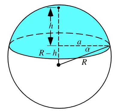

So you want to uniformly sample on a spherical cap. With the notations of this link, here is some pseudo-code which performs the sampling on the cap displayed in the above link (then it remains to perform a rotation):
stopifnot(h > 0 && h < 2 * R)
xy = uniform_point_in_unit_circle()
k = h * dotproduct(xy)
s = sqrt(h * (2 * R - k))
x = xy[1]
y = xy[2]
return (s * x, s * y, R - k)
I have this code in my archives, unfortunately I don't remember how I got it.
I put the image of the link here, in case it changes:

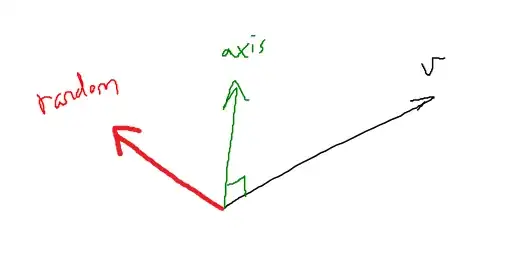

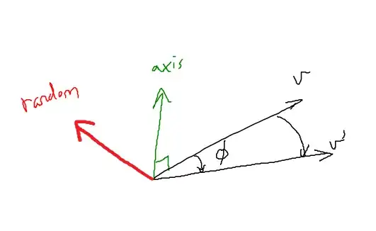

b) Use the following 3 steps to get a random vector that is at most $\theta$ degrees from $\vec{v}$:
1) Get any vector $\vec{\text{random}}$ on the unit sphere.
2) Cross $\vec{\text{random}}$ with $\vec{v}$ to get $\vec{\text{axis}}$
get a random perpendicular
3) Rotate $\vec{v}$ about $\vec{\text{axis}}$ by $\phi$ degrees, where $\phi = \sqrt{\text{random}( 0, \theta^2 )}$ ($\phi$ is the square root of uniformly distributed random scalar between 0 and $\theta^2$). This distribution of $\phi$ is important to avoid crowding at the pole.
rotate around that random perpendicular

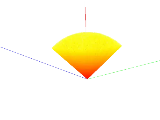

Result with a 45 degree spread:
45
45

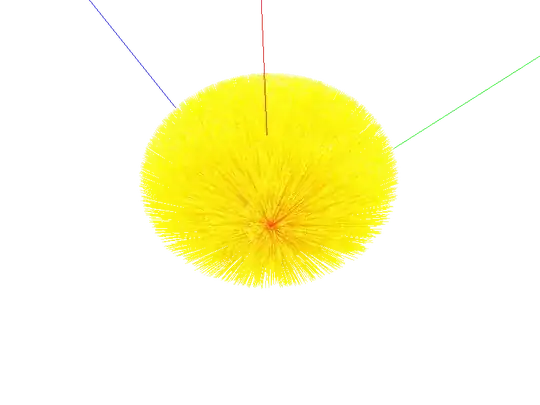

I've thought of another approach that seems to produce good results from quick visualization tests. I'd love to get feedback on this.
The 2D case is much simpler, I just have to add an angle within [-theta, theta] to the "cone" axis vector's angle and create a vector from the new angle. The 3D case is like a solid of revolution. I can generate an angle within [0, theta] and then move it in 3D space to a random rotation about the cone axis vector. I end up with the following algorithm:
axis = cone axis vector
angleAroundAxis = random(0, 2 * pi)
angleAwayFromAxis = random(0, theta)
matrix1 = rotation matrix of 'angleAroundAxis' around 'axis'
anyNormal = any vector that is normal to 'axis'
normal = anyNormal * matrix1
binormal = normal x axis
matrix2 = rotation matrix from 'axis', 'normal' and 'binormal' axes
result = [cos(angleAwayFromAxis) sin(angleAwayFromAxis) 0] * matrix2
Sorry if this is using non-standard notation, I'm not very familiar with formal math notation.
Trillian
  • 611
  • This won't result in a uniform distribution, since you're uniformly sampling $\theta$ where you should be uniformly sampling $z$ (see Christian's or my answer). – joriki Oct 01 '12 at 20:11
