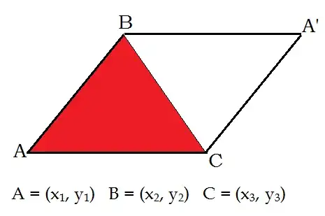

You know that AB × AC is a vector perpendicular to the plane ABC such that |AB × AC|= Area of the parallelogram ABA’C. Thus this area is equal to ½ |AB × AC|.
From AB= $(x_2 -x_1, y_2-y_1)$; AC= $(x_3-x_1, y_3-y_1)$, we deduce then
Area of $\Delta ABC$ = $\frac12$$[(x_2-x_1)(y_3-y_1)- (x_3-x_1)(y_2-y_1)]$

    This is the best answer, as it covers the 6005 and the Jailcu answers. Vector cross product. – richard1941 Aug 24 '16 at 21:09
  • By this way can area come as negative value? I am trying to understand this problem. http://www.geeksforgeeks.org/orientation-3-ordered-points/ – SRIDHARAN Dec 19 '17 at 13:39
  • What has been taken is the absolute value of the cross product. – Piquito Dec 20 '17 at 14:31
  • Yes it can be negative. The sign depends on the orientation of the three vertices. – Steven Alexis Gregory Feb 09 '18 at 07:03
  • Looking at the parallelogram, why not drop a perpendicular from C to AB. Now there are two right triangles whose area is easily found (You KNOW some coordinates.) No need to divide by 2 b/c the two right triangles cover the triangle under observation. – David Dyer Jul 12 '19 at 18:29
