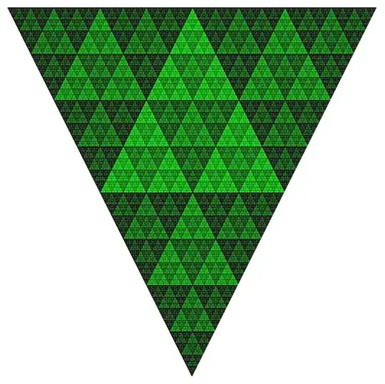

Edit (Dec. 6 2011): for fun, yesterday I asked myself how badly the equality $v_p\left({n \choose m}\right) = v_p(n)-v_p(m)$ fails for general $n$ and $m$. So I used Mathematica to create the following image. The triangle consists of the first 256 rows of Pascal's triangle, colored using the following rule: the greener a points is, the bigger the difference $v_2\left({n \choose m}\right) - v_2(n) +v_2(m)$. A little experimentation shows that any other choice of prime generates a similar image.
the triangle
To create this image, I used the p-adic arithmetic package and the following code:
p = 2; until = 256; t = Table[Table[{RGBColor[0, PadicOrder[Binomial[n, m]/(n/m), p]/Log[p, until], 0], Rectangle[{until/2 - 1/2 - n/2 + m, n}]}, {m, 1, n}], {n, 1, until}]; Graphics[t]
Bruno Joyal
