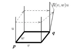

We consider the Riemann tensor first. A crucial observation is that if we parallel transport a vector $u$ at $p$ to $q$ along two different pathes $vw$ and $wv$, the resulting vectors at $q$ are different in general (following figure). If, however, we parallel transport a vector in a Euclidean space, where the parallel transport is defined in our usual sense, the resulting vector does not depend on the path along which it has been parallel transported. We expect that this non-integrability of parallel transport characterizes the intrinsic notion of curvature, which does not depend on the special coordinates chosen.

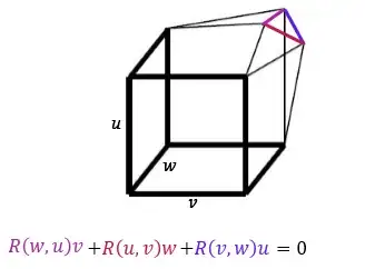

It is useful to say that in this sense visualization of the first Bianchi identity is very easy:

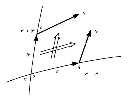

We next look at the geometrical meaning of the torsion tensor. Let $p \in M$ be a point whose coordinates are $\{x^μ\}$. Let $X = \varepsilon^μ e_μ$ and $Y = \delta^μ e_μ$ be infinitesimal vectors in $T_pM$. If these vectors are regarded as small displacements, they define two points $q$ and $s$ near $p$, whose coordinates are $\{x^μ + ε^μ\}$ and $\{x^μ + δ^μ\}$ respectively (following figure). If we parallel transport $X$ along the line $ps$, we obtain a vector $sr_1$ whose component is $\varepsilon^μ − \varepsilon^{\lambda} \Gamma^{\mu}_{\nu \lambda} \delta^{\nu}$ . The displacement vector connecting $p$ and $r_1$ is
$$pr_1 = ps + sr_1 = δ^μ + ε^μ − \Gamma^{\mu}_{\nu \lambda} \varepsilon^{\lambda} \delta^{\nu} .$$
Similarly, the parallel transport of $δ^μ$ along $pq$ yields a vector
$$pr_2 = ps + sr_2 = ε^μ + δ^μ − \Gamma^{\mu}_{\lambda \nu} \varepsilon^{\lambda} \delta^{\nu} .$$
In general, $r_1$ and $r_2$ do not agree and the difference is
$$r_2r_1=pr_2-pr_1=(\Gamma^{\mu}_{\nu \lambda}− \Gamma^{\mu}_{\lambda \nu})\varepsilon^{\lambda} \delta^{\nu}=T^{\mu}_{\lambda \nu} \varepsilon^{\lambda} \delta^{\nu} \qquad(*)$$
Thus, the torsion tensor measures the failure of the closure of the parallelogram made up of the small displacement vectors and their parallel transports.

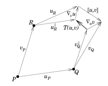

Now with respect to the above description it is easy to imagine the Torsion tensor in terms of the Lie bracket and connection:
$$T(u,v)=\nabla_u v −\nabla_v u−[u,v]$$

  • @Bakhoda: I have a question for you: what are $u_R$ and $u_R^{\parallel}$ supposed to represent? I imagine that $u_R^{\parallel}$ is the parallel transport of $u$ along the geodesic with initial vector $v$, but what about $u_R$? – Jesse Madnick Sep 13 '13 at 09:20
  • @ Jesse Madnick: $u$ is a vector field and $u_R$ is a vector that the vector field $u$ associate to point $R$. – Sepideh Bakhoda Sep 13 '13 at 10:13
