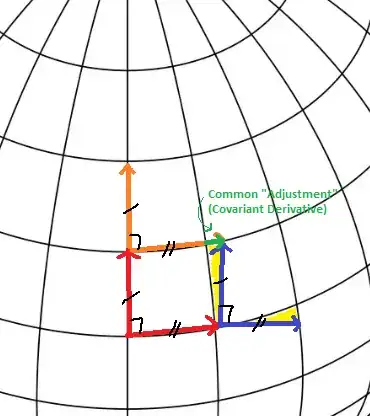

This is already very informative! On the one hand, we already know that our metric preserves lengths on $\mathcal{S}^2$, thus any Metric Compatible connection can only rotate the basis vectors of the Fibers and thus the Fibers themselves (no stretching, shearing, or reflections).
We can also see this numerically: As we move North our default measure sticks shrink, so if we want no size distortions in our map, we should adjust our horizontal "measure sticks" (horizontally) as we are moving vertically. This is what the term $\Gamma_{\theta \phi}^{\phi} = \cot\theta $ does.

This is where the extra degree of freedom comes in! A "sensible" choice would be to set $\Gamma_{\phi \theta}^{\phi} = \Gamma_{\theta \phi}^{\phi} = \cot\theta$ in which case we can also get:
$$\boxed{\Gamma_{\phi \phi}^{\theta} = -\sin\theta\cos\theta}$$
This is of course the Levi-Civita connection (once we set all other coefficients equal be zero).
Why is this "sensible"? For starters due to Metric Compatibility, our Fibers (Tangent Spaces) are again rotating. However we get more than that. The Fibers rotate in a compatible way, in the sense that the corners of their Grids seem to overlap locally.
This is what Zero Torsion does to the Fibers, and what quadrilateral closing looks locally.
(Formally, this is the best linear approximation or Taylor's expansion up to linear terms - which means there will be $O(\epsilon^2)$ errors - but for intuition purposes it suffices to imagine locally wrapping each $T_pM$ around $p$ on $M$). A picture is probably best to express this:
Notice that as we move North (red to orange), Metric Compatibility forces us to extend the horizontal "measuring stick" beyond where we would expect it to be based on our charting. This is to make sure that all frames look identical (up to rotation). To keep this new gridding consistent, we have to rotate our frame as we are moving East to compensate (red to blue).
This necessary "rotation of the squares" (ie. $\Gamma_{\phi \phi}^{\theta} \neq 0$ which means that transporting the $\partial_{\phi}$ basis vector in the "horizontal" $\partial_{\phi}$ direction picks up a shift in the the "vertical" $\partial_{\theta}$ direction, thus rotating $\partial_{\phi}$) is essentially what leads to non-zero curvature.
