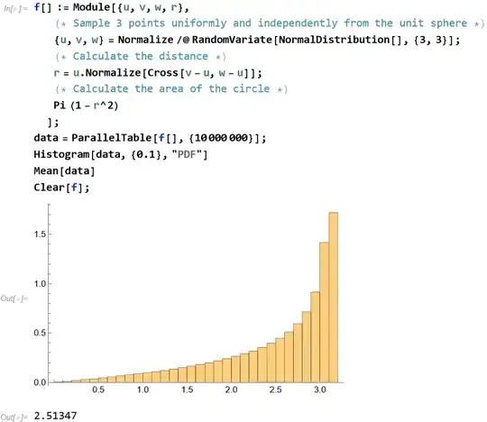

Below is a simulation of $10^7$ trials using Mathematica 13, demonstrating a sample mean that is quite close to the exact value above:
Simulation
