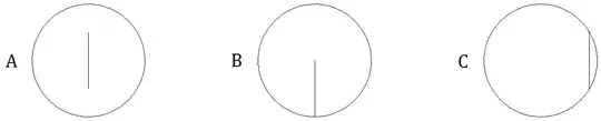

In a unit circle, where should you draw a unit line segment, to maximize the probability that it will be intersected by a random chord? The chord is drawn by connecting two uniformly random points on the circle.
The correct answer is C. In my experience, the most popular choice is A, followed by B, then C, but their actual probabilities are $\frac{1}{\pi^2}\int_0^\pi \arccos{\left(\frac{3}{\sqrt{25-16\cos^2{x}}}\right)}dx\approx 0.209, \frac{1}{4}=0.250, \frac{5}{18}\approx 0.278$, respectively. C gives the maximum probability of all possible locations of the line segment. See here for more information.
