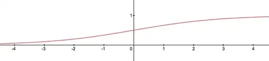

To make things simple, a suitable function is $F(x) = \frac{2^x}{1 + 2^x}$. (This is similar to the standard logistic function, but with base $2$ instead of base $e$.)
logistic function
I'll use this function in what follows. (As an aside, I don't think it's actually significant that $F(x)$ is a CDF; we're not drawing numbers from that distribution in any explicit sense. It's just a convenient shorthand for what we want it to look like.)

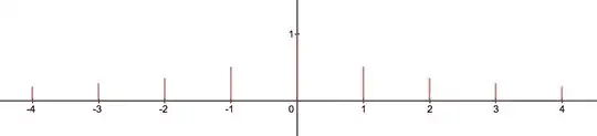

As an example, we might consider the double-ended sequence $a_n = \frac{1}{|n|+1}$, defined on the integers. (Note: This is not a distribution; we're going to take the expected value of a randomly selected value from this sequence, given a uniform distribution over larger and larger intervals.) The central portion of this sequence looks like this:
a double-ended sequence
It's clear that every value of this sequence is positive. But, we might ask, what is its average value? We can't evaluate this directly by just summing the product of each value and its probability, because as we said, there is no uniform distribution on the integers. We can't even add up the values and divide by the number of values, because both the sum and the count are infinite. The way we approach this is to consider the sum of the sequence for $n$ between $–m$ and $m$. This is related to the harmonic numbers $H_m$; the sum of our sequence is given by $2H_{m+1}–1$. We don't actually need to know the exact value of $H_m$; we only need to know a good upper bound. In this case, a good upper bound is $1+\ln m$, where $\ln$ denotes the natural log. This tells us that the sum of this sequence between $–m$ and $m$ is a positive value less than $1+2\ln(m+1)$. Since there are $2m+1$ values in all, the average of these values is bounded by
$$ E_m \leq \frac{1+2\ln(m+1)}{2m+1} $$
All we need to do now is see what what $E_m$ does as $m$ goes off to infinity. Of course, we only have an upper bound, and not $E_m$ itself, but there is a limit theorem, popularly called the squeeze theorem, that tells us (broadly speaking) that if we have a function that is always between two other functions, and the two other functions have the same limit, then the middle function must have the same limit. Since our average is always between $0$ and our upper bound, and our upper bound goes to $0$ (and $0$ obviously goes to $0$), our average must therefore go to $0$, even though it's the average of values that themselves are always positive!
