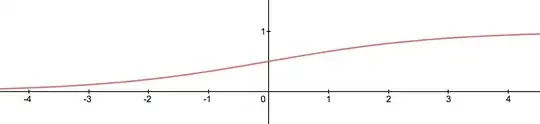

To make things simple, a suitable function is $F(x) = \frac{2^x}{1 + 2^x}$. (This is similar to the standard logistic function, but with base $2$ instead of base $e$.)
