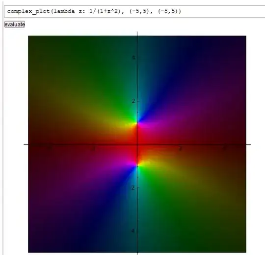

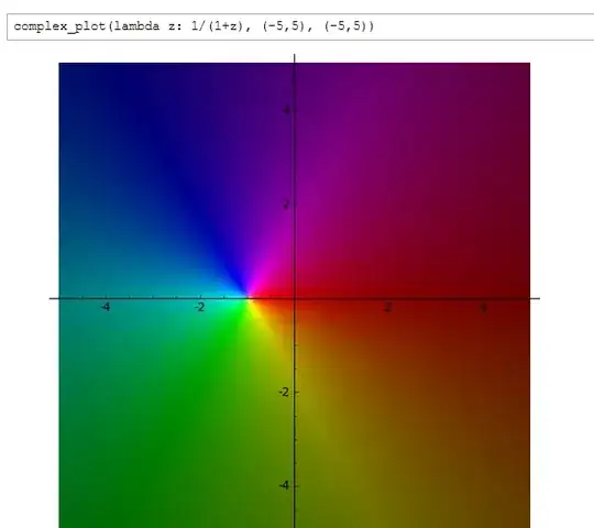

Following this guide to Sage: and using Sage Online produced the following graphs:
Graphing $\frac{1}{1-z}$ that way yeilds:
Graphing $\frac{1}{1-z^2}$ that way yields:
It would be nice to see it in 3D instead of merely color coded. The y-axis is coming out of the picture toward us and instead of seeing the 3D surface (in x,y,i coordinates) we see a color-graph on the x-i plane.

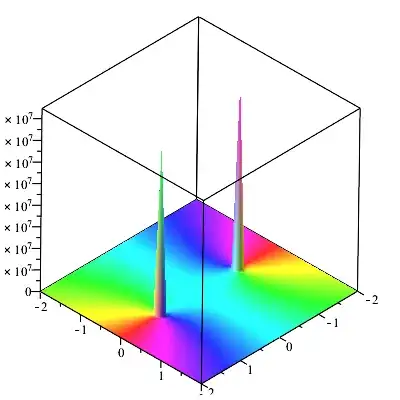

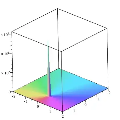

This is the codes in which you can visualize the complex functions in Maple's environment:
  [> with(plots):
  [> f := z-> 1/(1-z):
     g:=z-> 1/(1-z^2):
  [> complexplot3d(f, -2-2*I .. 2+2*I);
     complexplot3d(g, -2-2*I .. 2+2*I);

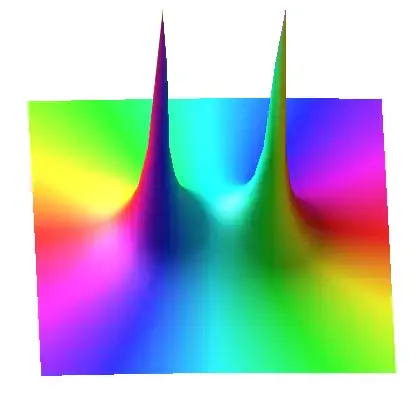

To the best of my knowledge, Sage at present does not offer 3d plots with color determined by a function. (But I'm not a Sage expert like those who inhabit ask Sage Q&A site.) As Babak S. pointed out, Maple does the job, for those who have access to it. However, I think the following picture (made with a different Maple command) looks nicer:
f:=1/(1-(x+I*y)^2):
plot3d(abs(f), x=-3..3, y=-3..3, color=argument(f), grid=[50,50]);
40 votes

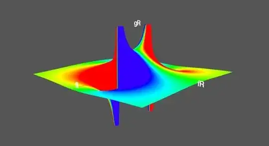

ADDED BY OTHER USER: AntonioVargas shared the following plot from Mathematica of $\text{Re}(1/(1+z^2))$ colored according to $\text{Im}(1/(1+z^2))$:
However it is just as easy to graph it in Wolfram Alpha
The graph the Re(1/(1+z^2) on Wolfram Alpha!
Also the 3D plot of the imaginary component.
