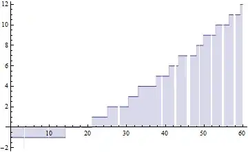

In the spirit of Raymond Manzoni's answer in combination with the Franca-LeClair asymptotic of the zeta zeros here, one can arrive at the following almost identical zeta zero counting function:
$$f(t)=\left\lfloor \frac{t \log \left(\frac{t}{2 e \pi }\right)}{2 \pi }+\frac{7}{8}\right\rfloor +\frac{1}{2} \left(-1+\text{sgn}\left(\Im\left(\zeta \left(i t+\frac{1}{2}\right)\right)\right)\right)$$
where only the singularities are different.
The plot looks like this:
counting function
Mathematica 8 code for the plot:
(*Mathematica 8*)
Plot[(Sign[Im[Zeta[1/2 + I*t]]] - 1)/2 +
  Floor[t/(2*Pi)*Log[t/(2*Pi*Exp[1])] + 7/8], {t, 0, 60},
 Filling -> 0]

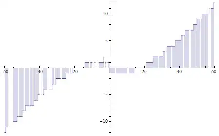

Just like Raymonds version also this counting function can be made symmetrical:
Plot[Re[(Sign[Im[Zeta[1/2 + I*t]]] - 1)/2 +
   Floor[t/(2*Pi)*Log[t/(2*Pi*Exp[1])] + Sign[t]*7/8 +
     If[t < 0, 2, 0]]], {t, -60, 60}, Filling -> 0]
zeta zero counting symmetry
