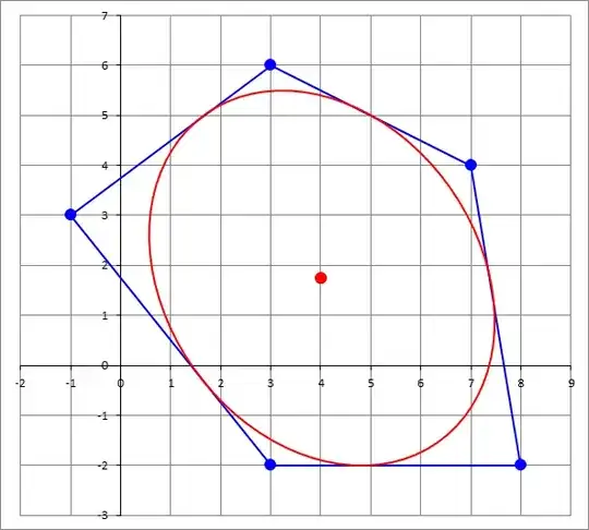

Let $A,B,C,D,E$ be the vertices of a convex pentagon (ordered counterclockwisely). Let $G$ be its center of mass and $K$ be the center of its in-ellipse.

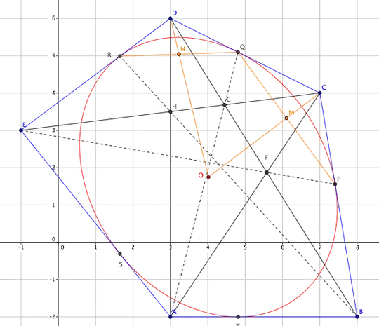

What's remain is to justify $(*4)$. Since under affine transform, the ratio of areas remains invariant. It suffices to verify $(*4)$ when the inellipse is the unit circle centered at origin and $A$ lies on the +ve $x$-axis.
Let $A_1,B_1,C_1,D_1,E_1$ be points on the inellipse touching the pentagon edges $CD$, $DE$, $EA$, $AB$, $BC$ respectively. Let
$$2\alpha = \angle C_1OD_1, 2\beta = \angle D_1OE_1, 2\gamma = \angle E_1OA_1, 2\delta = \angle A_1OB_1, 2\epsilon = \angle B_1OC_1$$
It is not hard to see the vertices are located at
