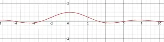

Let us have a visual of the function being integrated
When we state the purely real integral $$I_1 = \int_{-\infty}^{\infty} \frac{\sin x}{x}dx$$ this is short-hand for $$I_1 = \lim_{a \to -\infty} \lim_{b \to \infty} \int_{a}^{b} f(x) dx$$ where $$f(x) = \begin{cases} \frac{\sin(x)}{x} & x \not = 0 \\ 1 & x = 0 \\ \end{cases}$$
The convergence of this integral must be addressed. It does not converge absolutely so we should attempt to cancel parts of the integral with itself. We will show that the right side (from $2\pi$ to $\infty$) converges by chopping it up and subtracting the negative part of each sine wave from the positive part. For each segment we have
$$\begin{align} &\, \left|\int_{\pi 2 k}^{\pi (2 k + 2)} \frac{\sin(x)}{x} dx\right| \\ \le&\, \left|\int_{\pi 2 k}^{\pi (2 k + 1)} \frac{\sin(x)}{x} - \frac{\sin(x)}{x + \pi} dx\right| \\ \le&\, \left|\int_{\pi 2 k}^{\pi (2 k + 1)} \frac{\sin(x)}{\pi (2 k + 1)} - \frac{\sin(x)}{\pi (2 k + 2)} dx\right| \\ \le&\, \left|\int_{\pi 2 k}^{\pi (2 k + 1)} \frac{\sin(x)}{\pi} \left[\frac{1}{2 k + 1} - \frac{1}{2 k + 2}\right] dx\right| \\ \end{align}$$
and the alternating harmonic series converges. Note that each segment is positive and their sum converges absolutely. Note that we showed the integral from $0$ to $\infty$ converges independently of the integral from $-\infty$ to $0$.
The finite part from $0$ to $2 \pi$ easily converges as we always have $\sin(x)/x \le 1$.
